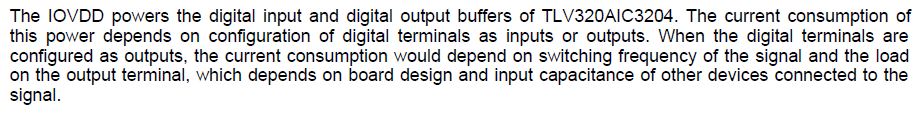

    Would you be able to give us some idea of how the current consumption can be calculated?
    Regarding HPVDD, I consider it as the supply of the headphone driver so I'm taking the highlighted value in the picture below.
    Is that appropriate?
    Regarding IOVDD, it seems a bit tricky according to the description below.
    And it doesn't seem to be related to ADC, either.
    Therefore, could you please give us some idea on how the power consumption looks like?
    Or, in other words, what would be the power budget you would recommend for AIC3204?
    Thank you!
    Roy Hsu
  • Hi, Roy,
    The power data from HPVDD can be considered as you pointed out, however you need to also consider the recording data if the ADC is being used (section 2.5.2 or ARG). IOVDD consumption can be considered negligible as the current demanded is quite small, a typical value that you can  consider for the IOVDD current is about 20µA for playback and 60µA for recording.
