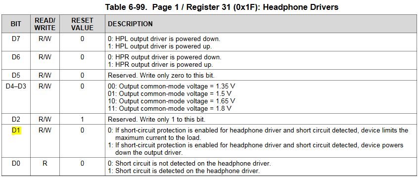

We have used TLV320DAC in our project and we are using the Headphone lines for the audio out for which, we have 3.5mm Audio Jack.
We have the following issue :
When we connect the headset without mic then audio functionality is working fine in stereo mode whereas when we connect the Headset with Mic then there is short circuit event detected and Audio working only in Mono mode.
What is the reason for the short circuit event short circuit event happening and is there any way to work Headset with the MIC in stereo mode?
