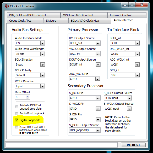

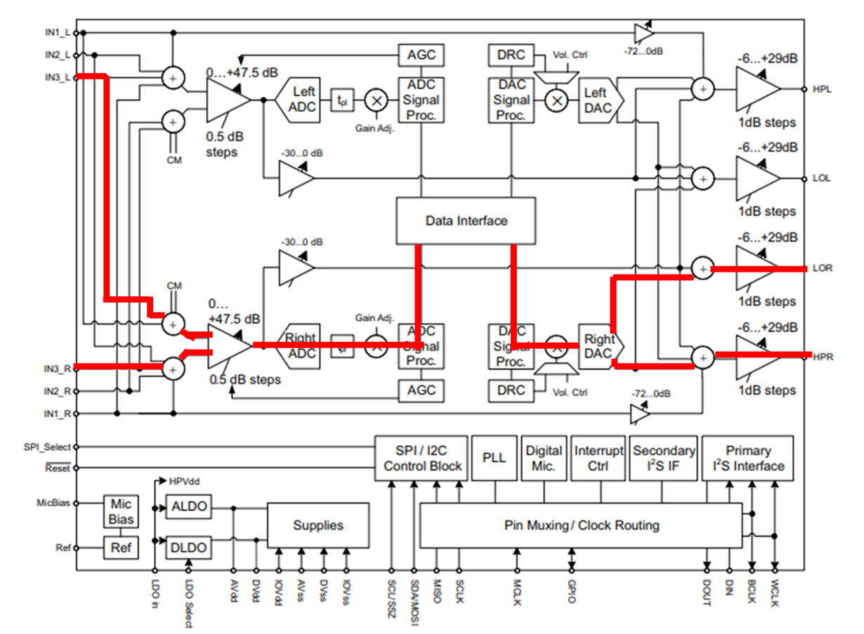

I would like to connect the root of TLV320AIC3254EVM as below. In order to compare the performance difference between with DSP and without DSP condition, I would like to bypass DSP block and connect internal ADC to DAC directly but I could not.
Could you tell me procedure which allows us to connect as below on the GUI? Or Could you share any macros to import the settings?
Takashi Onawa
  • Hi, Takashi,
    The 'AIC3254 features a loopback option that will connect the ADC output to the DAC input internally. Please Take a look to Page 0 / Register 29, bit D4. In the CS software, this option can be enabled in the Audio Interface Tab of the Clocks/Interface Window as shown below:

  • Hi Diego-san,
    Thanks for your quick response on this.
    I can do it with following procedure.
    [Typical Configurations]
    Recording → Audio Recording Tab → Select "High Performance Stereo Recording(IN1)" and Push "LOAD"
    [Digital Settings]
    Clocks / Interface → Dividers tab → Push "Program USB Audio Settings" button
    Clocks / Interface → Audio Interface tab → Check "Digital Loopback"
    [Analog Settings]
    Audio Outputs → Output Routing tab → Headphone Output Routing → check "LDAC_P" and "RDAC_P"
    Audio Outputs → DAC / Line Outputs tab → DAC Output Gain Control → Check "Power"s
    Audio Outputs → Headphone Outputs tab → HP Output Gain Control → Check "Power"s
    I could set the EVM as the following condition
    - Stereo Input from IN1
    - Bypass internally(ADC to DAC)
    - Stereo Output
