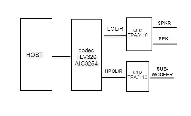

Can I use HP out L/R to achieve 2.1 channel audio in use TLV320AIC3254 ??
When I use HP out L/R  what  can  I use to commend it ? Or you have any great suggestion
as below as image is block diagram
if you have any recommend pls  let me know
Thanks your  great support
attached the image is block diagram

    The 'AIC3254 might be able to be used with this configuration by using the LOL as the Left output, LOR as the right output and HPR as the Mono output. The mono signal can be generated by routing both left and right DAC outputs to HPR output. One thing to consider is that under this configuration, the gain of the HPR output will require attenuation of 6dB to meet the same amplitude of the line outputs.

    Thanks your reply  .and I think another question . if i use HP out to achieve woofer function  so need I  add low-pass OP schematic before AMP ?
    AIC3254 include DSP  can support woofer???
