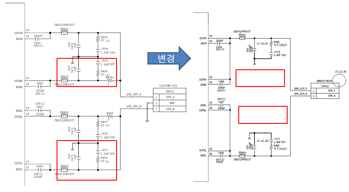

Hello!
My customer wants our review before schematic change.
This change makes efficiency improvement of speaker amp as they tested with 4ohm 5W mono speaker.
Could you concirm please? Thank you.
  • Hi Kenneth,
    The above left circuit shows the post-filter PBTL mode, while the right one shows the pre-filter PBTL. In the pre-filter PBTL connection mode, only two filter are needed and two filter can be saved comparing to post-filter connection. TPA3130D2 can support the both connection mode very well.
    I found that the capacitors in the output filter are changed from 1nF to 100pF, why? I think you need to use the same filter configuration for pre-filter mode. The RC snubbers after the ferrite bead + capacitor output filter is basically used for the EMI supression and you could adapt the RC values during EMI tunning.
    Shawn Zheng
  • Hi Shawn,
    Thank you for your prompt answer in detail. Your explanation helps me a lot. I recommended to use 1nF for output filter capacitor instead of 100pF.
