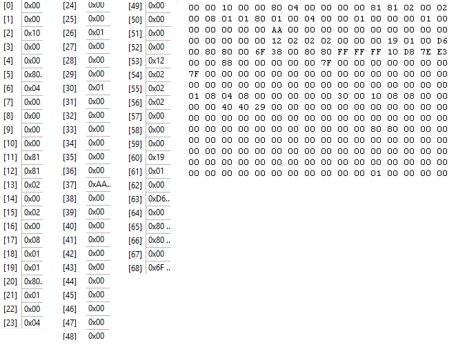

  • Thanks Jose, sorry for the delay, been working thru other issues with the board. I did try the settings as suggested but no luck seeing anything out of the Left/Right pins..
    // MCLK pin is input to PLL
    // PLL Clock is CODEC_CLKIN
    Write (PAGE_0, 0x4, 0x3);
    // PLL powered up
    // PLL_P = 1
    // PLL_R = 1
    Write (PAGE_0, 0x5, (1<<7) | (1<<4) | (1<<0));
    //PLL_J = 12
    Write (PAGE_0, 0x6, 12<<0);
    /PLL_D = 0
    Write (PAGE_0, 0x7, 0);
    Write (PAGE_0, 0x8, 0);
    // NDAC = 5
    // MDAC = 5
    // DOSR = 128
    Write (PAGE_0, 0xB, (1<<7) | ( 5<<0);
    Write (PAGE_0, 0xC, (1<<7) | ( 5<<0);
    Write (PAGE_0, 0xD, (128<<0);
    Doing a readback of the regs, it verifies the intended settings above, as well as having the beep generator bit enabled (0x47=0x80). I also see the 8Mhz MClk. Is there another register that might be the issue?

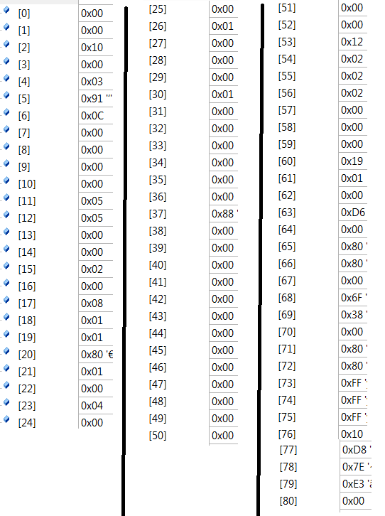

  • Lewis,
    What have you set to Page 0x01 Reg 0x09? What about Reg 0x0C and 0x0D from the same Page 0x01?
    You should completely configure the device in terms of clock and routing settings.
    From your read back I see that Page 0x00 Reg 0x25 is 0x88, which means that LDAC and RDAC are powered but HPL and HPR are not.
    -Ivan Salazar
    Applications Engineer - Low Power Audio & Actuators
  • Interesting, sometimes I enable power to it, but the readback on Reg 25 shows 0x88..  perhaps it takes some time to turn on.
     I've had crazy power issues on the board, but I do see clean power at the chip   (3.3V IOVDD and  1.8V DVDD/AVDD/HPVDD).

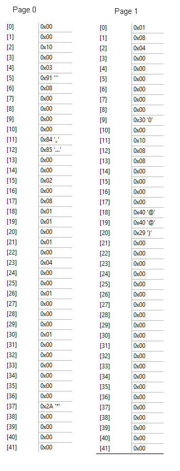

  • Lewis,
    Have you checked the output? Any chance there could be a short at the output that leads the device into protection?
    -Ivan Salazar
  • The output doesn't seem to be shorted to anything...   I do see a little blip when the command to turn on the output power is sent,  so it seems ok, except for there's never any wave.       Was there anything in the page 1 register dump that seems unusual?   Is the order in which the registers are written critical to the operation?
