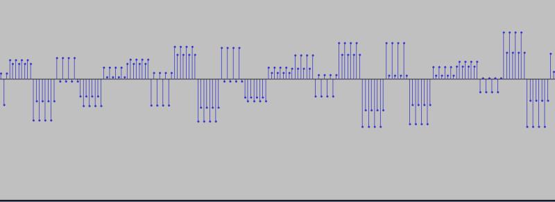

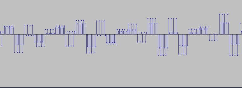

Our desired sampling rate is 16KHZ, and we can record but seems the PCM data is abnormal. Pls help to check and comment.
our clock setting, we didn't input MCLK
BCLK input :1.024MHZ
LRCK input:16KHZ
desired DOUT: left-justified, 32bit, 16KHZ

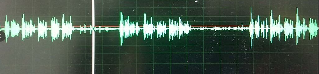

    but I have one more question, I think the PCM data has some DC voltage, I want to use a filter to remove it. Do you have any suggestions?

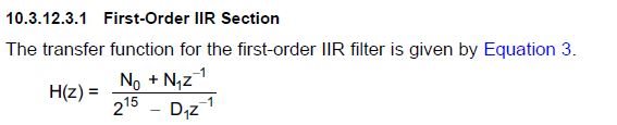

    Datasheet mentioned that 'A firstorder IIR filter is always available, and is useful to filter out possible dc components of the signal efficiently', so it can remove the DC voltage? How can I use it?
    Thanks for the feedback. This is an expected behavior of this part as there is a small offset variation on the ADC; this variation  can be compensated by changing the values of Page 1 / Register 26: Dither Control.

    this offset setting can approve a little, but I want to know if First-Order IIR filter can remove the DC completely? Thanks.

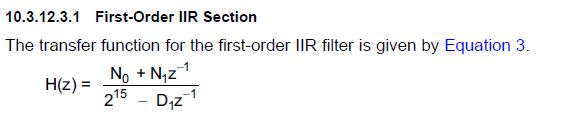

    The first order IIR filter can be used to  help with the removal of DC components. In order to configure the filter, you need to generate the coefficients for the high pass filter of your choice (the TI biquad tool can be used) and write them into the corresponding register location, as described in section 10.3.12.3.1 of the datasheet.

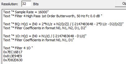

    how to use the TI biquad tool?
    I chose the highpass filter, 16KHZ, 32bit and I got a file, so which parameter is N0,N1 and N2?
    The TI Biquad tool generates the required coefficients as soon as they are generated with the graphical interface. On the Coefficients window, the text in the top will specify the filter type and the format for each type of filter. In the case of 1st order filters (1O), the three lines represent the three coefficients, N0, N1 and D1 respectively. The resolution specification is not the audio data size, it is the coefficient size for the biquads of a given device. For the 'ADC3101, the coefficient size is 16 bit.
    For example, for the filter you are trying to accomplish, the coefficients would be:
    High Pass 1st Order Butterworth, 50 Hz Fc 0.0 dB
    N0 = 0x7EC0
    N1 = 0x8140
    D1 = 0x7D81
    The coefficients generated should be written to the specific location indicated in section 10.3.12.3.1 of the datasheet.
