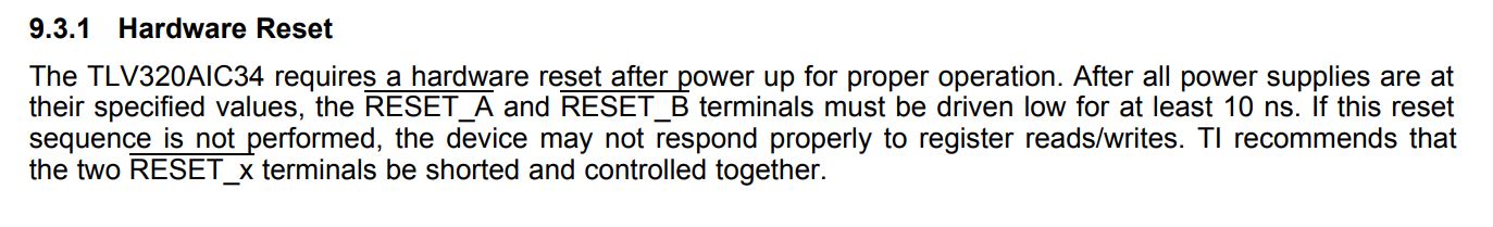

After reset the TLV320AIC34IZAS  do not respond to the I2C access. The codec do not recognize his I2C address.
My question is: what is the minimum length of the RESET pulse  and how long will take to the CODECs to became active after the RESET?
I mention that the two RESET signals are not tied together.
