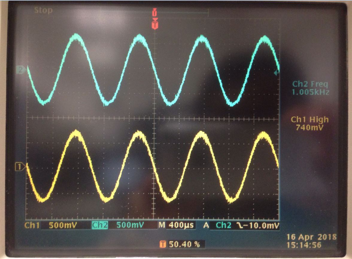

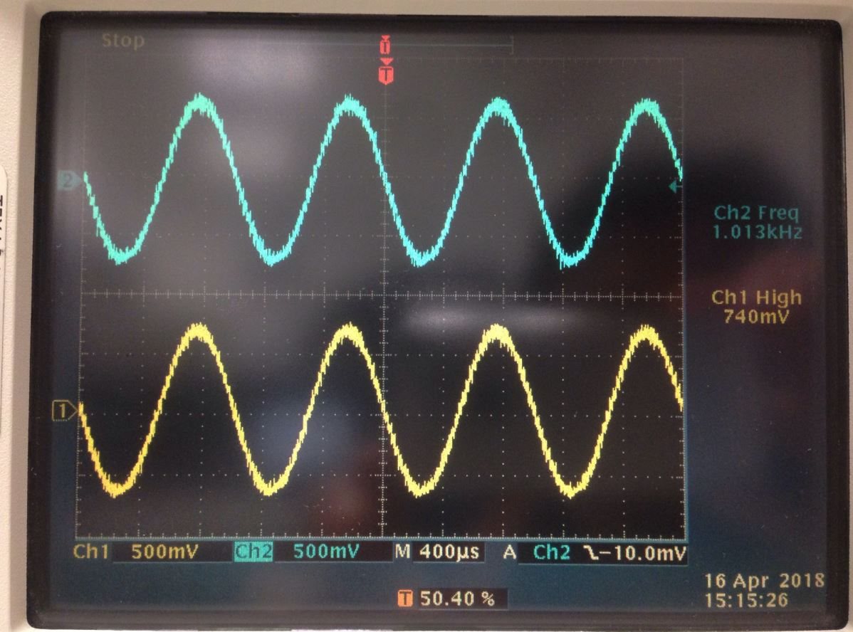

  • Mani,
    I tried the register sequence from your original post and the output signal is good, although there is some little distortion:
    Then I tried to change only the following things as I suggested earlier: NDAC = 1, MDAC = 2, DOSR = 128 and the output signal is completely OK:
    So the command sequence seems to be fine.
