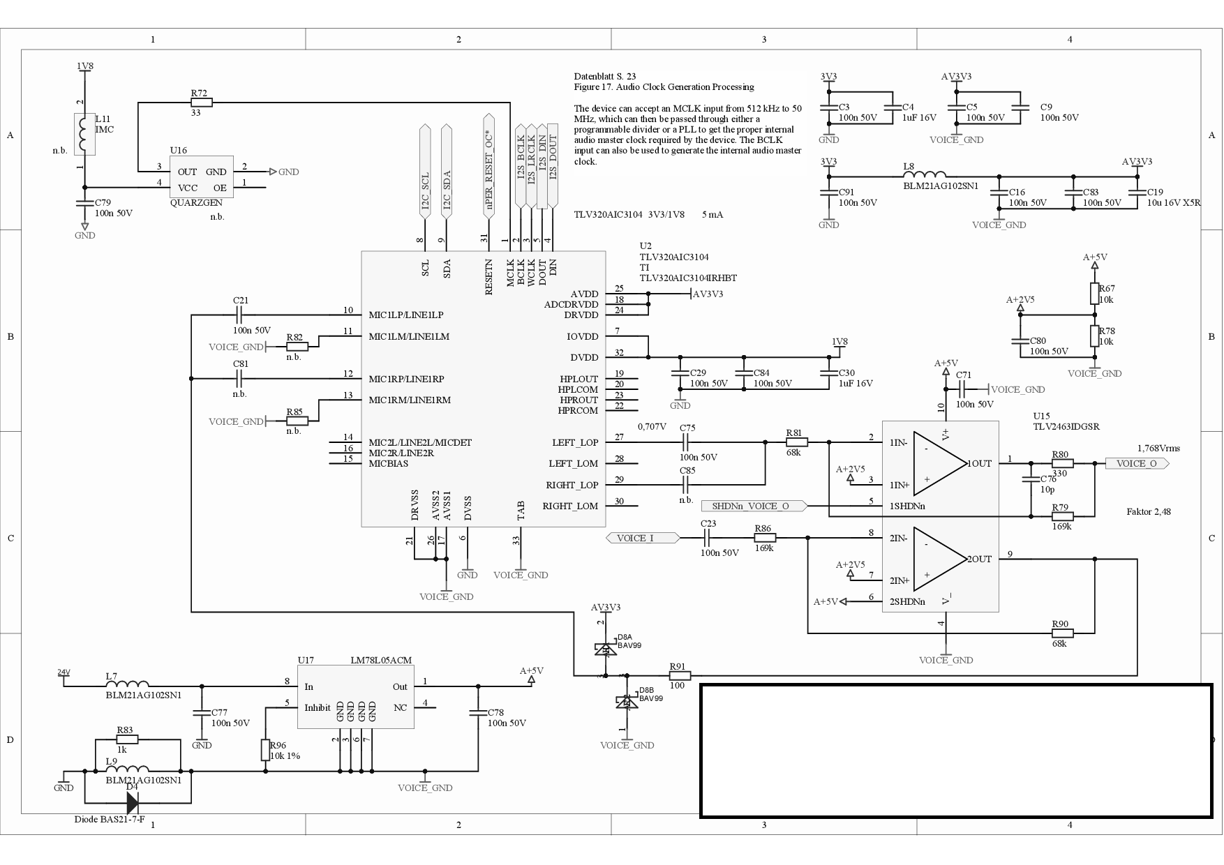

the schematic of the codec:
What is wrong with my configuration?

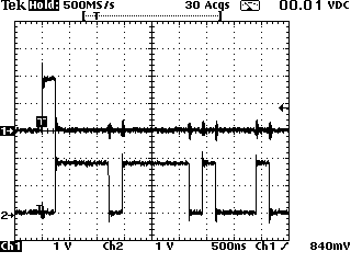

    The following signals are supplied to the codec:
    Channel 1: WCLK
    Channel 2: BCLK
    Channel  1: WCLK
    Channel 2: DIN (16 Bit/ sample)

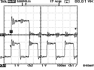

     Channel  1: WCLK
    Channel 2: DIN (16 Bit/ sample, whole cycle)

    New questinions:
    1. To use the LEFT_LOP as single ended output, there is no special configuration for this.
    I only have to use LEFT_LOP based to AGND, is this ok?
    2. If I do so with my second configuration, the signal LEFT_LOP+ before the low pass, is quiet (noise less than 20 mVss).
    After I use the test tone of windows sound driver the first time the noise rises to 300 mVss. Both at frequencys of 1 MHz.
    Is this normal?
    After the low pass filter of the eval-board the signal is ok.
    The noise stays althoug I switch of BCLK and MCLK.
    Best regards
    Gregor
