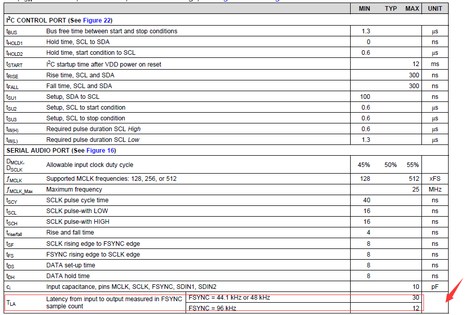

Help to check TAS6424L-Q1 GROUP DELAY time, more little more better to me.
Hi Leo,
This data is not readily available. I will make an inquiry to our design team to see if this data is available.
Hi Leo,
Are you referring to latency through the IC, not the Group Delay? Latency is listed in the datasheet, under the spec TLA
