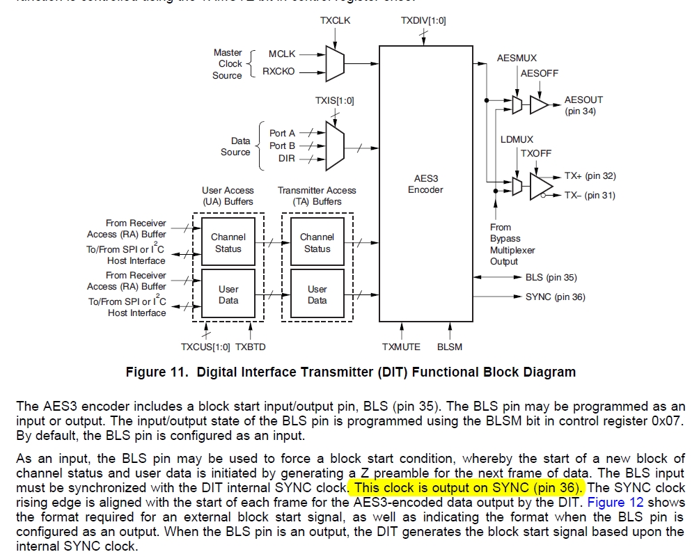

what is the founction of BLS and SYNC?
How should BLS and SYNC used in system?
Please give some examples of utility of BLS and SYNC.

    As far as the BLS (Block START) usage goes, in some applications, it may be necessary to control the precise timing of the transmitted AES3 frame boundaries.
    As an input, the BLS pin may be used to force a block start condition, whereby the start of a new block of channel status and user data is initiated by generating a Z preamble for the next frame of data. The BLS input MUST be synchronized w. SYNC clock as shown in Fig 12 in the DS.
    Hope this clarifies the use of BLS/SYNC pins.
