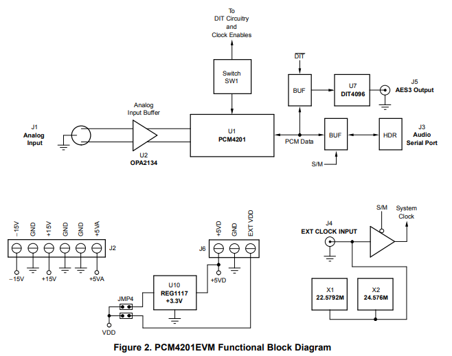

I'd like to ask about audio ADC, PCM4201.
How big is the dimensions of PCM4201EVM?

Hi Tatsumi-san,
The dimension of the PCM4201 EVM is 4"x4".
NOTE that the EVM has DIT block to convert I2S output of ADC into S/PDIF format and has buffer circuitry associated with it for ease of evaluation purpose only. The EVM was designed to reflect the true solution size for PCM4201 based solution if that's the intention for asking this question.
Please see below diagram for functional diagram of the PCM4201 EVM...
