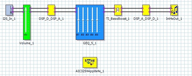

my ctm cinfig tlv320aic3254 like this pic
but the LOL/LOR has no signal out, and I2S has no output.
They guess there has something wrong with the config of PLL or power.
Any possible to share the config of the PLL and power and let ctm has some output first.
tlv320aic3254
  • HI, Piero,
    Based on the shared diagram, if the system settings code of PurePath Studio (PPS) is not modified, you should be able to see the an output signal through LOL and LOR outputs. I²S output is not configured on the process flow, so it is not expected to get an output there.
    PLL and power parameters are configured by the Systems Settings code in PPS, and are set correctly by default. Are you using the EVM to test this configuration?. What is the sampling rate used and digital audio source used?. What is the audio source used to provide the I²S input for your test?

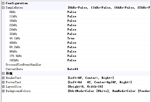

  • ctm can only find below setting in PPS
    Would you help for where they can " adjust the PLL coefficients in the systems settings code in PPS to accept the 24MHz MCLK and derive the internal clocks properly"
  • Hi, Piero,
    The System Settings Code I referred before is located in the properties section of the Framework.  Please refer to this wiki entry to find how to change the system settings of the PPS process flow.
      -Diego Meléndez López
       Audio Applications Engineer

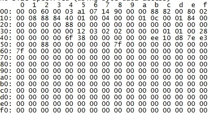

  • have set the  the PLL coefficients with 2 ways.
    1)
    %%if (%%prop(SampleRate) == 44100 || %%prop(SampleRate) == 48000)
           reg[  0][  5] = 0x91    ; P=1, R=1, J=8
           reg[  0][  6] = 0x08    ; P=1, R=1, J=8
           reg[  0][  7] = 0x00    ; D=0000 (MSB)
           reg[  0][  8] = 0x00    ; D=0000 (LSB)
           reg[  0][  4] = 0x03       ; PLL_clkin = MCLK, codec_clkin = PLL_CLK, PLL on
           reg[  0][ 12] = 0x88   ; MDAC = 8, divider powered on
           reg[  0][ 13] = 0x00   ; DOSR = 128 (MSB)
           reg[  0][ 14] = 0x80   ; DOSR = 128 (LSB)
           reg[  0][ 18] = 0x02   ; NADC = 2, divider powered off
           reg[  0][ 19] = 0x88   ; MADC = 8, divider powered on
           reg[  0][ 20] = 0x80   ; AOSR = 128
           reg[  0][ 11] = 0x82   ; NDAC = 2, divider powered on
           %%endif

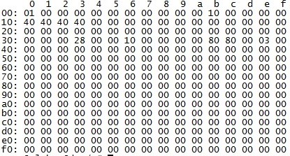

    2)set register with I2C as the page0 and page1 as below
    But still can not get the clk out.
    Pls suggest.

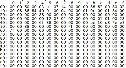

  • Hi, Piero,
    Apart from the PLL clock configuration, in order to configure the device in master mode, you need to configure BCLK and WCLK as outputs, as well as enable and configure  the BCLK divider. For this, you need to configure register Page 0 / Register 27 and Register 30.
    The PLL settings you shared seems as the default ones for the EVM, which are fine when a MCLK of 12.288MHz is used. if 12MHz clock is used, coefficient D of the PLL should be 1920.
  • OK,See the clk out after set register 30.
    For coefficient D, I didn't find how to calculate the value on the slaa408a.pdf
    Currently the MCLK is 24M, what's the value we should set for coefficient D?
  • Hi, Piero,
    Thanks for the feedback. If the input MCLK is 24MHz, both coefficients J and D should be updated. J should be set to 4 and D should be set to 960. the information about the PLL coefficient calculation is available in section 2.7.1 of the Applications Reference Guide. Basically you need to write a hex 960 (0x03C0)  value into registers 4 and 5 to configure coefficient D.
