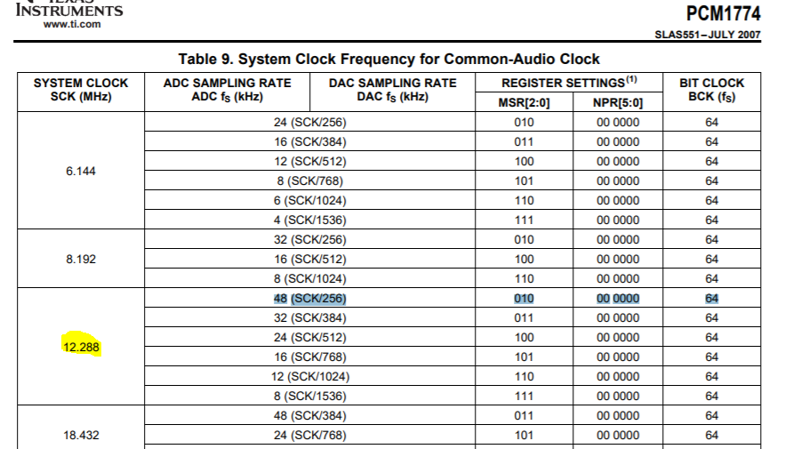

PCM1774: BCK to set as 32 FS
Part Number: PCM1774
        In our embedded application we would like to set BCK as 32 fs (1.536MHz). looking at the specification we couldn't find this information in Table 9(System Clock frequency for common audio clock). But In Clock diagram, we are able to see support for 32 fs. (Figure 16. Audio data formats)
System clock frequency(MCLK) : 12.288MHz
LR Clock : 48KHz
can you please help us to get this.
