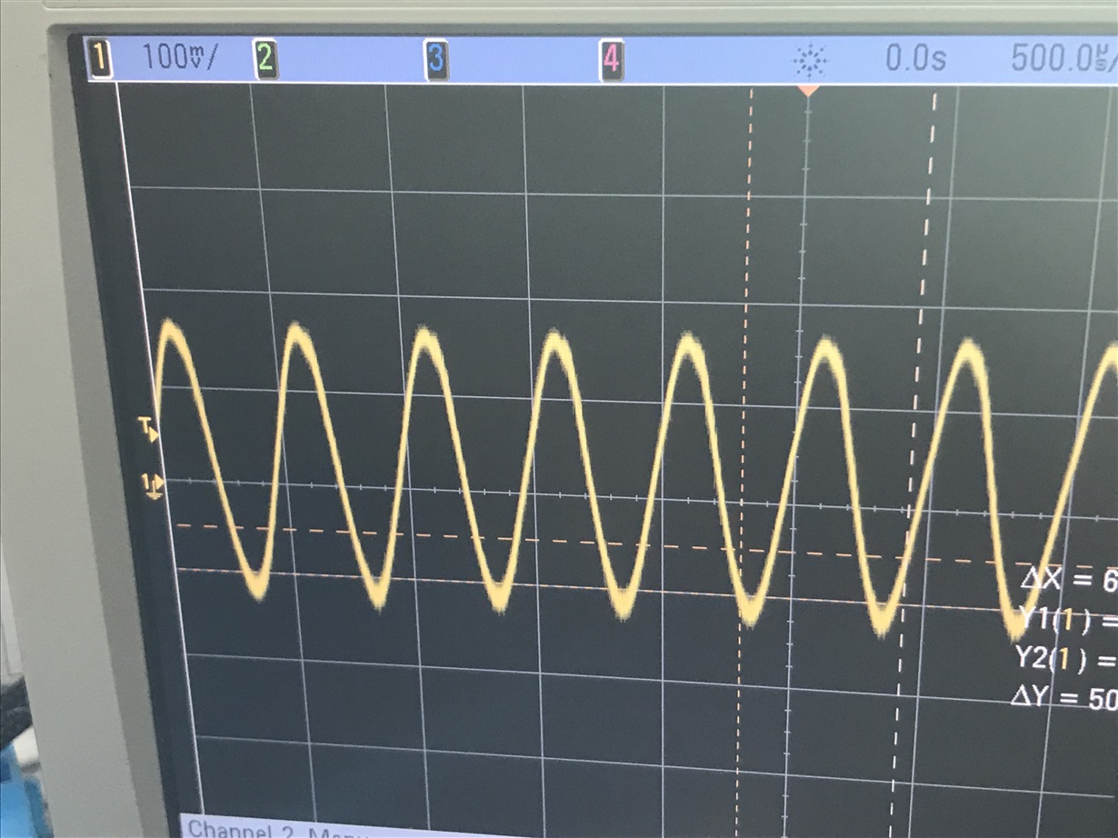

"We have a class D AMP output "pollute the power supply issue". We use TI Class D amp "TPA2039D1YFF".
In our application, we use +5V from USB host and the +5V will also be used for other circuitry like audio preamp. Once the amp output is high, there will be a second harmonic reflect to the +5V power rail.
Here is a sample photo for you reference. The input signal is 1k sine wave, the audio output is about 1w@4R+33uH dummy load. You will see the 2kHz ripple(300mV pp) on the power supply rail of 2039.
I checked the demo kit of 2039 and also looks similar.
Do you have any suggestion to improve this? Or any suggestion to change to a good class D AMP?"
Please see attachment for the waveform.

    having a look into the datasheet of TPA2039 you will notice, that this amplifier is intended to be powered by a battery? This would explain the rather small recommended decoupling capacitance of 10µF. Me thinks that this capacitance is much too small when the TPA2039 is powered by voltage regulator instead. So, I would first try to increase the decoupling capacitance of TPA2039 before switching to another chip.

    This seems to be a decoupling problem. TPA2039D1 is a Class-D audio amplifier that requires adequate power supply decoupling to ensure the efficiency is high and total harmonic distortion (THD+N) is low.
    It would be useful if you can provide me a schematic to review it.

  • Hi, we asked for the schematics, will advise. We did get the following paraphrased:
    "For our application, we use USB(connected to PC) power supply for the this Class AMP and we have limitation to increase the decoupling caps. Because of the I-rush issue.
    I use 1k sine wave input and output level is 1W@4R.
    I had tried increasing the decoupling cap to 220uF or even 470uF. There is improvement but ripple is still high.
    As you mentioned, I had tried with a good regulator(LTC3127EDD, 5v to 4.5v) between USB input and AMP power supply. The ripple is nearly gone at the 5V side. But still high at 4.5V side.
    Any comments?"
  • Hi Dave,
    1W at 4R means a load current of 0.71Ap!
    Kai
