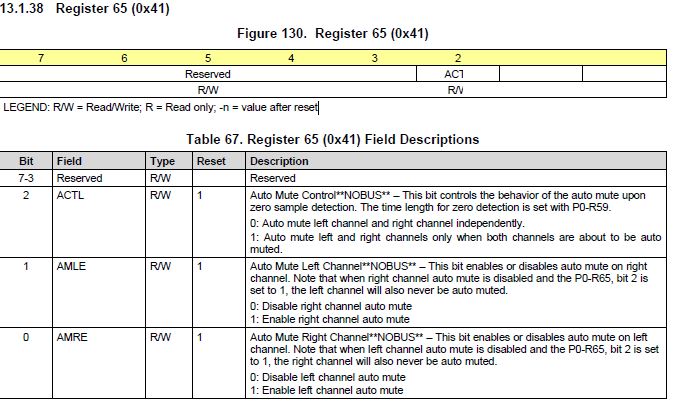

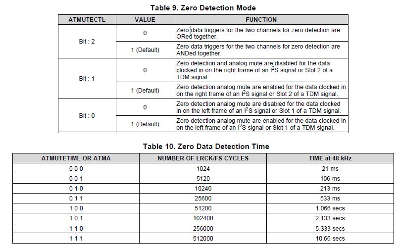

Please refer to the TAS5782's page 0x0, register 0x41’s configuration. we found that the TAS5782 enters auto mute mode when input signal lower than -53dB FS, and resume to normal operation when higher than -50dB FS. 3dB hysteresis. Is it in-line with TAS5782’s design?
