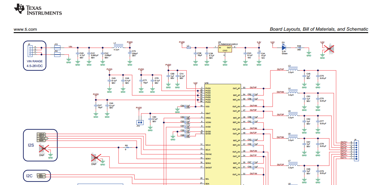

CE Test on EMC is Failed .We had already rectified power supply and the parameters of load Resistance-Capacitance were still not OK .CE can be passed only After the 6624 power supply is completely removed .
  • Hi Lizelle,
    have you followed all the guidelines given in section 12 of datasheet (4-layer PCB, 70µm copper, solid ground plane, a.s.o.)? Do you have the same pi-filter at the power supply input like the EVM board (330µF, 4.7µH, 4.7µF, 82nF, 220pF)?
