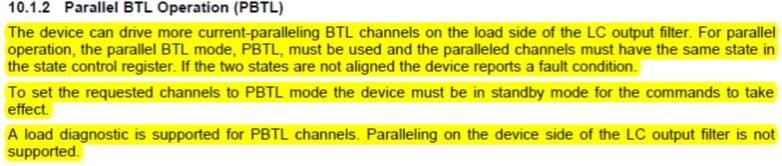

  • Hi Marc,
    It's your favorite TI engineer again.  Thanks for your candid comments.  As my favorite philosopher Billy Joel wrote "You maybe right, I maybe crazy ..."
    Yes, we have customers who use PBTL mode as per the data sheet and it works.
    The caveat is (1) put the device in standby, (2) write to register 00 bit D4 and/or D5 to put the channels in PBTL mode.  The statement in the data sheet describes both (1) and (2).  But I want to make it clear here.
    Hope this answer is timely that you haven't spin your PCB already.
    Best, Tuan

    Paragraph 10.1.2 doesn't really communicate how the two channel outputs are to be connected.  It rather more is stating
    about the I2C setup registers and that is part of my initial question from a few weeks ago.  I have been setting all four
    channels to "play" (0x00).  I do sometimes get "DC load error" on one leg of a channel, this might be due to not putting
    them all in "standby" wait a few milliseconds then set the new states, I can test/adjust that.

    Busy day messing with this. The section you send 10.1.2 states "device must be in standby mode for the commands to take
    effect". Now, if you look at "Table 5: Operating Modes", it states that in standby mode, I2S and I2C are "stopped", I take this to
    mean the I2C in the device is not running and thus can not accept commands until standby mode is released?
    If this is the case, can I release (pull high) standby input then initialize the device with the PBTL setup (reg: 0x00=0xc0)???
    By saying "...channels must have the same state...", does this mean set both channels to PLAY (channel 1 and 2 to PLAY)?
    Also, now I am pulsing the standby input low back to high, waiting 100mS then performing the full I2C register initialization.
    I don't see any timing requirements when coming out of standby to wait before doing this or how long standby needs to
    be as a pulse if using it that way. Would it be the same if I used the "reset device" bit in register 0x00, D7?
    If I did that reset method how long before the device is ready to accept I2C setup commands?
    Sure would have been a great solution if TI had supplied a simple source code library that dealt with the device and
    all of it's details for us guys out there that have limited knowledge of a fairly technical part such as this one.
    What say you?
    Marc Y.
