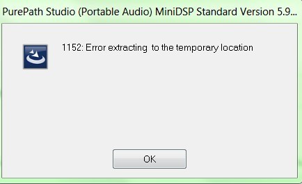

I got the PPS software. when I clicked to install it, it pop up  an Error window as below, please kindly suggest how to fix it. thanks.
I tried to download  several times, but the result is same, My PC OS is WIN7.

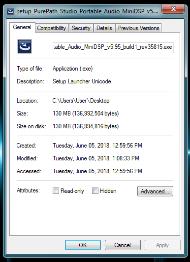

    I am having the same issue on Win 7 SP1 x64. Downloading from a different network did not help so far. Could you please provide the exact file size (in bytes) and possibly a checksum of the working file to compare?

    This has been a strange issue, unfortunately the only workaround we have found is the network change. On below image you can find the exact size of the installer file.

  • Hi Diego,
    I am having the same problem and am unable to install PPS. I downloaded and tried installing multiple times on different PC's (incl. a VM with WinXP) and on different networks (office and home) and all have the same or similar problem.
    The downloaded file is the same size as what you describe above.
    In some cases it says "1152: Error extracting to the temporary location."
    In other cases it says "Error reading setup initialization file."
    I tried cleaning up the TMP directory. I tried setting the environment variables TMP and TEMP to a new clean location in a CMD window and start the setup from there. All still the same error.
