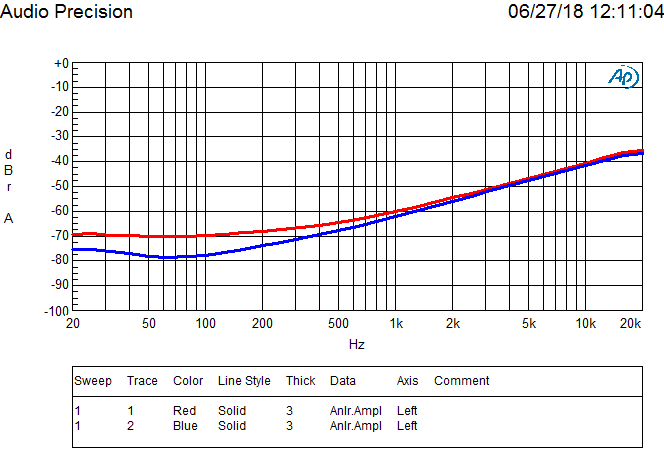

Dear Ivan,
I am not sure what I measured is correct, please check my testing in attachment. Could you share your test diagram? I have no idea how you can produce a diagram (CMRR vs frequency).
Hi Ian,
You can follow the procedure explained in the following site: www.ap.com/.../
Once you have the CMRR measurement on analog analyzer (CMTST) you just need to to a sweep were source is Gen. Freq and Data is Anlr. Ampl.
Below is a sweep I did with an EVM.
