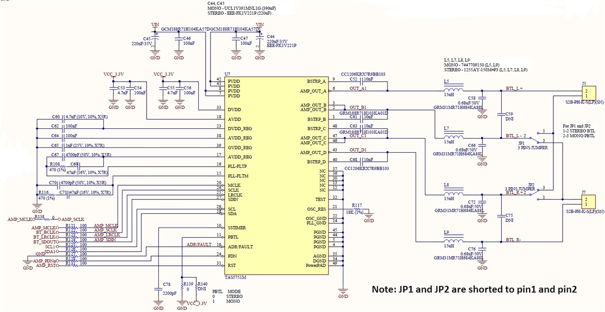

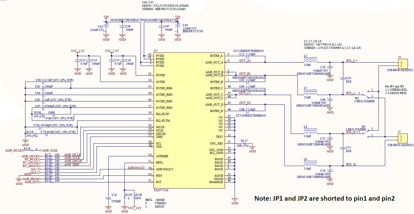

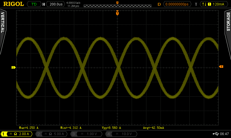

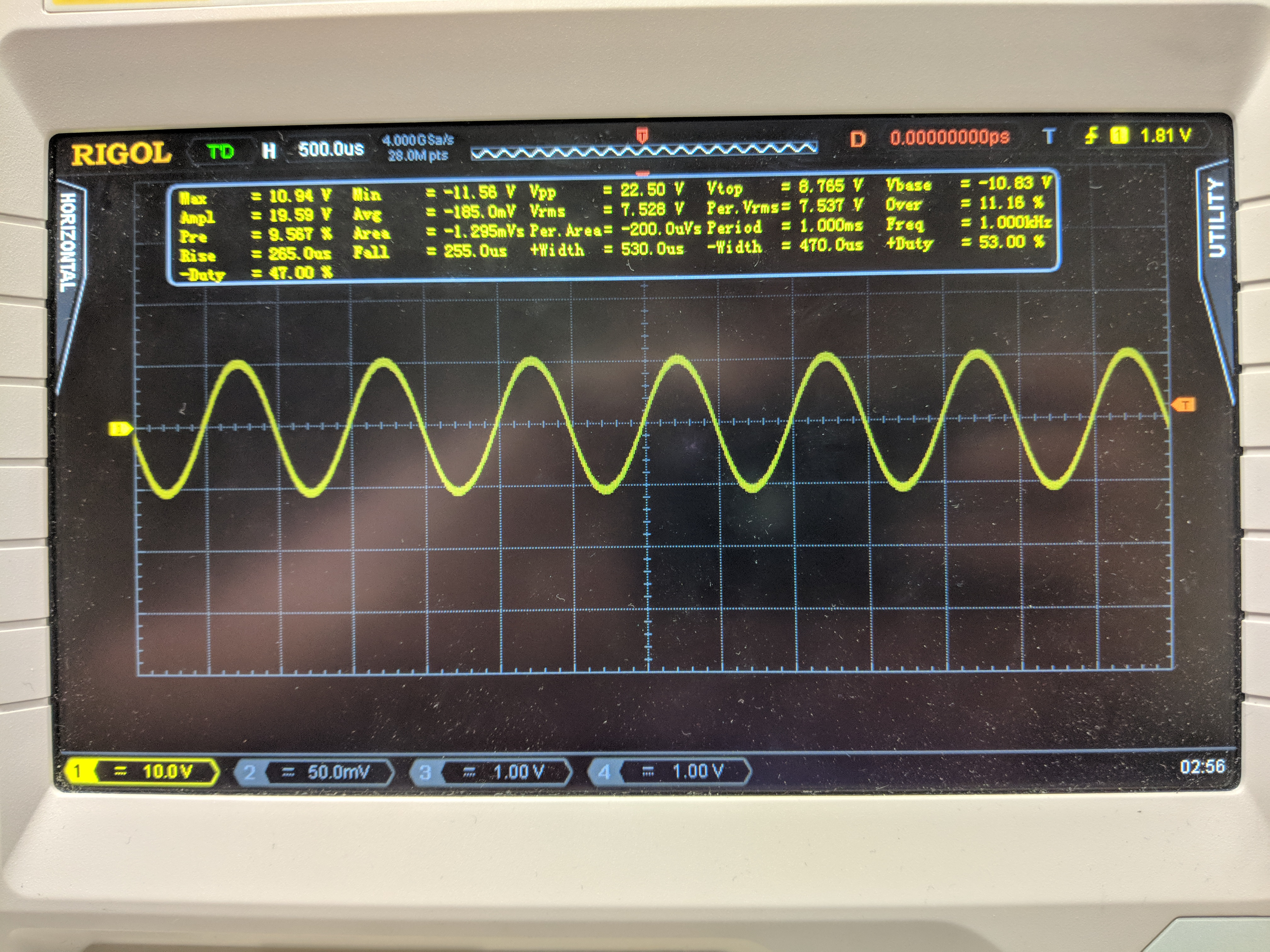

I am using the TAS5751M on my custom board and we found one issue during testing. The issue is when increase the input voltage to around 15V the speaker start to has clipping sound. We did couple things to try to resolve the issue and end up removing the 0.68uF capacitors on the output, the clipping sound goes away and I can increase the input up to 21V without any issues. *C22,C23, C25 and C26 on TI's reference schematic.
I am not sure, what is the root cause for this issue. I am thinking that may related to the layout design.
Do you have any ideas how to identify the root cause?
Our application info.
• 4ohm speaker
• 2 layers board
• Components and schematic are following TI's reference schematic (For Stereo Device).
• We are configuring the amplifier to be used in Mono mode - by gang configuring Left and Right channels.
