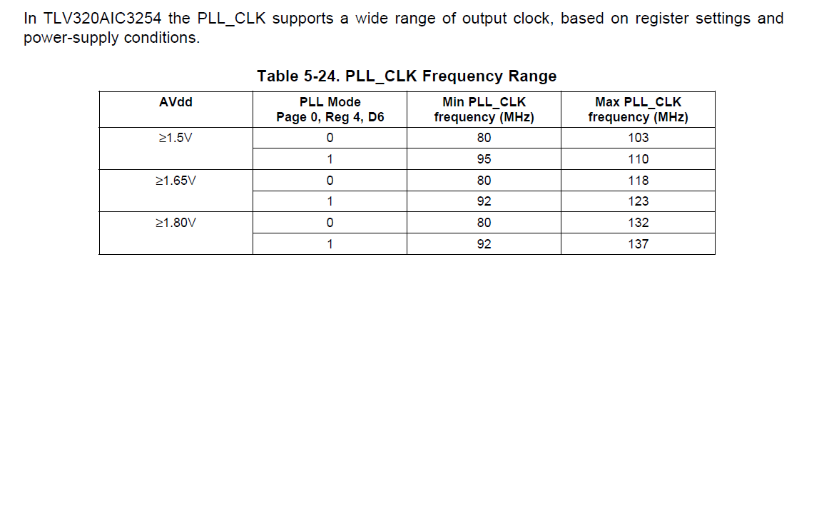

    In the meantime I think I've found a first problem:The PLL must be set so, that the internal CLK is 98 MHz and the OSR has to be identical.

  • Hi Hui,
    indeed this piece of code was the solution:
    ; Take 770 KHz BCLK as PLL input clock
    ; R=4, P=1, J=32, power up PLL
        reg[  0][  6] = 0x20;
        reg[  0][  4] = 0x07;
        reg[  0][  5] = 0x94;
    Perhaps it would be worth to document somewhere, that the resulting PLL output Clock should be 98 MHz for the miniDSP operation.
    Thanks for your help!
    Micky
  • I am glad it works!
    thanks for the suggestions. As a matter of fact, the PLL clock configuration varies a lot application by application.
    In your specific application, since you don't have MCLK, we take the BCLK as the PLL input clock. The codec_CLKIN doesn't need to be 98 MHz, however it cannot go over 110 MHz.
    I think what we really need to document is a few case studies that demonstrate how to configure the clocks. Attached is an app note wrriten by my colleague, which covers part of this discussion.

  • Hi Micky,
    Please also see the attached for PLL clock rate constraints. It's taken from AIC3254 datasheet.
    /Hui
