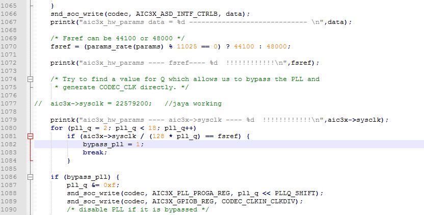

we have interfaced TLV320AIC3105 with custom processor.  When I play wav file using "aplay" ($ aplay song.wav)  I am not getting system clock(sysclk), it is showing as 0, eventually playback is not successful. In tlv320aic3x.c  codec driver aic3x_hw_params() showing as unable to set PLL and hw_params :-22 errors. I have put debugs in the same function(see below)
During playback I am getting following errors,
aic3x_hw_params START------!!!!!!!!!!!!!
aic3x_hw_params ---- width= 16 !!!!!!!!!!!!
aic3x_hw_params ---- data==== 0 !!!!!!!!!!!!
aic3x_hw_params case16 !!!!!!!!!!!
aic3x_hw_params data = 0 !!!!!!!!!!!!!!!!!!!
aic3x_hw_params ---- fsref---- 44100 !!!!!!!!!!!!
aic3x_hw_params ---- aic3x->sysclk ---- 0 !!!!!!!!!!!!
aic3x_hw_params(): unable to setup PLL
tlv320aic3x-codec 1-0018: ASoC: can't set tlv320aic3x-hifi hw params: -22

    Thanks for your response.
    As I have seen aic3x_hw_params() get called by aic3x_dai_ops()  in the driver code as given below,
    static const struct snd_soc_dai_ops aic3x_dai_ops = {
    .hw_params = aic3x_hw_params,
    .prepare = aic3x_prepare,
    .digital_mute = aic3x_mute,
    .set_sysclk = aic3x_set_dai_sysclk,
    I have attached tlv320aic3x.c codec and my machine driver imx_tlv320.c code herewith for more information.

    	/*struct device_node *cpu_np, *codec_np;
    	struct platform_device *cpu_pdev;
    	struct i2c_client *codec_dev;
    	struct imx_tlv320_data *data;
    	int ret;*/
    	struct device_node *cpu_np, *codec_np = NULL;
    	struct imx_priv *priv = &card_priv;
    	struct platform_device *asrc_pdev = NULL;
    	struct device_node *asrc_np;
    	u32 width;
    	int ret;
    	priv->pdev = pdev;
    	dev_err(&pdev->dev, "imx_tlv320aic3105_probe...\n");
    	cpu_np = of_parse_phandle(pdev->dev.of_node, "cpu-dai", 0);
    	if(!cpu_np){
    		dev_err(&pdev->dev, "cpu-dai missing or invalid\n");
    		ret = -EINVAL;
    		goto fail;
    	codec_np = of_parse_phandle(pdev->dev.of_node, "audio-codec", 0);
    	if (!codec_np) {
    		dev_err(&pdev->dev, "phandle missing or invalid\n");
    		ret = -EINVAL;
    		goto fail;
    	cpu_pdev = of_find_device_by_node(cpu_np);
    		if (!cpu_pdev) {
    		dev_err(&pdev->dev, "failed to find SAI platform device\n");
    		ret = -EINVAL;
    		goto fail;
    #if 0
    	if (strstr(cpu_np->name, "ssi")) {
    		ret = imx_tlv320aic3x_audmux_config(pdev);
    		if (ret) {
    			dev_err(&pdev->dev, "Filed @imx_tlv320aic3x_audmux_config\n");
    			goto fail;
    #endif
    	codec_dev = of_find_i2c_device_by_node(codec_np);
    	if (!codec_dev || !codec_dev->dev.driver) {
    		dev_err(&pdev->dev, "failed to find codec platform device\n");
    		ret = -EINVAL;
    		goto fail;
    	data = devm_kzalloc(&pdev->dev, sizeof(*data), GFP_KERNEL);
    	if (!data) {
    		dev_err(&pdev->dev, "failed @devm_kzalloc\n");
    		ret = -ENOMEM;
    		goto fail;
    	if (of_property_read_bool(pdev->dev.of_node, "codec-master"))
    		data->is_codec_master = true;
    	data->codec_clk = devm_clk_get(&codec_dev->dev, "mclk");
    	if (IS_ERR(data->codec_clk)) {
    		ret = PTR_ERR(data->codec_clk);
    		dev_err(&pdev->dev, "failed to get codec clk: %d\n", ret);
    		goto fail;
    	ret = of_parse_gpr(pdev, data);
    	if (ret)
    		goto fail;
    	/*of_property_read_u32_array(pdev->dev.of_node, "hp-det", data->hp_det, 2);*/
    	asrc_np = of_parse_phandle(pdev->dev.of_node, "asrc-controller", 0);
    	if (asrc_np) {
    		asrc_pdev = of_find_device_by_node(asrc_np);
    		priv->asrc_pdev = asrc_pdev;
    	data->card.dai_link = imx_tlv320_dai;
    	imx_tlv320_dai[0].codec_of_node	= codec_np;
    	imx_tlv320_dai[0].cpu_dai_name = dev_name(&cpu_pdev->dev);
    	imx_tlv320_dai[0].platform_of_node = cpu_np;
    	if (!asrc_pdev) {
    		data->card.num_links = 1;
    	} else {
    		imx_tlv320_dai[1].cpu_of_node = asrc_np;
    		imx_tlv320_dai[1].platform_of_node = asrc_np;
    		imx_tlv320_dai[2].codec_of_node	= codec_np;
    		imx_tlv320_dai[2].cpu_dai_name = dev_name(&cpu_pdev->dev);
    		data->card.num_links = 3;
    		ret = of_property_read_u32(asrc_np, "fsl,asrc-rate",
    				&data->asrc_rate);
    		if (ret) {
    			dev_err(&pdev->dev, "failed to get output rate\n");
    			ret = -EINVAL;
    			goto fail;
    		ret = of_property_read_u32(asrc_np, "fsl,asrc-width", &width);
    		if (ret) {
    			ret = -EINVAL;
    			goto fail;
    		if (width == 24)
    			data->asrc_format = SNDRV_PCM_FORMAT_S24_LE;
    		else
    			data->asrc_format = SNDRV_PCM_FORMAT_S16_LE;
    	data->card.dev = &pdev->dev;
    	data->card.owner = THIS_MODULE;
    	ret = snd_soc_of_parse_card_name(&data->card, "model");
    	if (ret)
    		goto fail;
    	data->card.dapm_widgets = imx_tlv320_dapm_widgets;
    	data->card.num_dapm_widgets = ARRAY_SIZE(imx_tlv320_dapm_widgets);
    	ret = snd_soc_of_parse_audio_routing(&data->card, "audio-routing");
    	if (ret)
    		goto fail;
    	/*data->card.late_probe = imx_wm8960_late_probe;*/
    	platform_set_drvdata(pdev, &data->card);
    	snd_soc_card_set_drvdata(&data->card, data);
    	ret = devm_snd_soc_register_card(&pdev->dev, &data->card);
    	if (ret) {
    		dev_err(&pdev->dev, "snd_soc_register_card failed (%d)\n", ret);
    		goto fail;
    	priv->snd_card = data->card.snd_card;
    #if 0
    	imx_hp_jack_gpio.gpio = of_get_named_gpio_flags(pdev->dev.of_node,
    			"hp-det-gpios", 0, &priv->hp_active_low);
    	imx_mic_jack_gpio.gpio = of_get_named_gpio_flags(pdev->dev.of_node,
    			"mic-det-gpios", 0, &priv->mic_active_low);
    	if (gpio_is_valid(imx_hp_jack_gpio.gpio) &&
    	    gpio_is_valid(imx_mic_jack_gpio.gpio) &&
    	    imx_hp_jack_gpio.gpio == imx_mic_jack_gpio.gpio)
    		priv->is_headset_jack = true;
    	if (gpio_is_valid(imx_hp_jack_gpio.gpio)) {
    		priv->headphone_kctl = snd_kctl_jack_new("Headphone", NULL);
    		ret = snd_ctl_add(priv->snd_card, priv->headphone_kctl);
    		if (ret)
    			dev_warn(&pdev->dev, "failed to create headphone jack kctl\n");
    		if (priv->is_headset_jack) {
    			imx_hp_jack_pin.mask |= SND_JACK_MICROPHONE;
    			imx_hp_jack_gpio.report |= SND_JACK_MICROPHONE;
    		imx_hp_jack_gpio.jack_status_check = hp_jack_status_check;
    		imx_hp_jack_gpio.data = &imx_hp_jack;
    		ret = imx_wm8960_jack_init(&data->card, &imx_hp_jack,
    					   &imx_hp_jack_pin, &imx_hp_jack_gpio);
    		if (ret) {
    			dev_warn(&pdev->dev, "hp jack init failed (%d)\n", ret);
    			goto out;
    		ret = driver_create_file(pdev->dev.driver, &driver_attr_headphone);
    		if (ret)
    			dev_warn(&pdev->dev, "create hp attr failed (%d)\n", ret);
    	if (gpio_is_valid(imx_mic_jack_gpio.gpio)) {
    		if (!priv->is_headset_jack) {
    			imx_mic_jack_gpio.jack_status_check = mic_jack_status_check;
    			imx_mic_jack_gpio.data = &imx_mic_jack;
    			ret = imx_wm8960_jack_init(&data->card, &imx_mic_jack,
    					&imx_mic_jack_pins, &imx_mic_jack_gpio);
    			if (ret) {
    				dev_warn(&pdev->dev, "mic jack init failed (%d)\n", ret);
    				goto out;
    		ret = driver_create_file(pdev->dev.driver, &driver_attr_micphone);
    		if (ret)
    			dev_warn(&pdev->dev, "create mic attr failed (%d)\n", ret);
    #endif
    out:
    	ret = 0;
    fail:
    	if (cpu_np)
    		of_node_put(cpu_np);
    	if (codec_np)
    		of_node_put(codec_np);
    	return ret;
    #if 0
    	data->codec_clk = clk_get(&codec_dev->dev, NULL);
    		dev_err(&pdev->dev, "data->codec_clk is invalid\n");
    		/* assuming clock enabled by default */
    		data->codec_clk = NULL;
    		ret = of_property_read_u32(codec_np, "clock-frequency", &data->clk_frequency);
    		if (ret) {
    			dev_err(&codec_dev->dev, "clock-frequency missing or invalid\n");
    			goto fail;
    	} else {
    		data->clk_frequency = clk_get_rate(data->codec_clk);
    		clk_prepare_enable(data->codec_clk);
    		dev_err(&pdev->dev, "data->codec_clk is correct: %d\n", data->clk_frequency);
    	data->dai.name = "HiFi";
    	data->dai.stream_name = "HiFi";
    	data->dai.codec_dai_name = "tlv320aic3x-hifi";
    	data->dai.codec_of_node = codec_np;
    	data->dai.cpu_of_node = cpu_np;
    	data->dai.platform_of_node = cpu_np;
    	data->dai.init = &imx_tlv320_dai_init;
    	data->dai.dai_fmt = SND_SOC_DAIFMT_I2S | SND_SOC_DAIFMT_NB_NF |
    			    SND_SOC_DAIFMT_CBM_CFM;
    	if (ret) {
    		dev_err(&pdev->dev, "failed @snd_soc_of_parse_card_name");
    		goto clk_fail;
    	if (ret) {
    		dev_err(&pdev->dev, "failed @snd_soc_of_parse_audio_routing");
    		goto clk_fail;
    	data->card.dai_link = &data->dai;
    	ret = snd_soc_register_card(&data->card);
    	if (ret) {
    		goto clk_fail;
    	platform_set_drvdata(pdev, data);
    clk_fail:
    	clk_put(data->codec_clk);
    fail:
    	if (cpu_np)
    	if (codec_np)
    	return ret;
    #endif
    static int imx_tlv320_remove(struct platform_device *pdev)
    	struct imx_tlv320_data *data = platform_get_drvdata(pdev);
    	if (data->codec_clk) {
    	clk_disable_unprepare(data->codec_clk);
    	snd_soc_unregister_card(&data->card);
    	return 0;
    static const struct of_device_id imx_tlv320_dt_ids[] = {
    	{ .compatible = "fsl,imx-audio-tlv320", },
    	{ /* sentinel */ }
    MODULE_DEVICE_TABLE(of, imx_tlv320_dt_ids);
    static struct platform_driver imx_tlv320_driver = {
    	.driver = {
    		.name = "imx-tlv320",
    		.owner = THIS_MODULE,
    		.pm = &snd_soc_pm_ops,
    		.of_match_table = imx_tlv320_dt_ids,
    	.probe = imx_tlv320_probe,
    	.remove = imx_tlv320_remove,
    module_platform_driver(imx_tlv320_driver);
    MODULE_AUTHOR("Srinivasan <srinivasan.s@tataelxsi.co.in>");
    MODULE_DESCRIPTION("imx with TLV320AIC3105 codec ASoC machine driver");
    MODULE_LICENSE("GPL v2");
    MODULE_ALIAS("platform:imx_tlv320aic3105");

    	/* Fsref can be 44100 or 48000 */
    	fsref = (params_rate(params) % 11025 == 0) ? 44100 : 48000;
    	printk("aic3x_hw_params ---- fsref---- %d  !!!!!!!!!!!!\n",fsref);
    	/* Try to find a value for Q which allows us to bypass the PLL and
    	 * generate CODEC_CLK directly. */
    //	aic3x->sysclk = 22579200;	//jaya working
    	printk("aic3x_hw_params ---- aic3x->sysclk ---- %d  !!!!!!!!!!!!\n",aic3x->sysclk);
    	for (pll_q = 2; pll_q < 18; pll_q++)
    		if (aic3x->sysclk / (128 * pll_q) == fsref) {
    			bypass_pll = 1;
    			break;
    	if (bypass_pll) {
    		pll_q &= 0xf;
    		snd_soc_write(codec, AIC3X_PLL_PROGA_REG, pll_q << PLLQ_SHIFT);

    static int aic3x_set_dai_sysclk(struct snd_soc_dai *codec_dai,
    				int clk_id, unsigned int freq, int dir)
    	struct snd_soc_codec *codec = codec_dai->codec;
    	struct aic3x_priv *aic3x = snd_soc_codec_get_drvdata(codec);
    	printk("aic3x_set_dai_sysclk clk_id !!!!!!!%d\n", clk_id);
    //	clk_id  = 2; //jaya
    	/* set clock on MCLK or GPIO2 or BCLK */
    	snd_soc_update_bits(codec, AIC3X_CLKGEN_CTRL_REG, PLLCLK_IN_MASK,
    				clk_id << PLLCLK_IN_SHIFT);
    	snd_soc_update_bits(codec, AIC3X_CLKGEN_CTRL_REG, CLKDIV_IN_MASK,
    				clk_id << CLKDIV_IN_SHIFT);
    	printk("aic3x_set_dai_sysclk!!!!!!!%d\n", freq);
    //	freq = 22579200;  //jaya
    	aic3x->sysclk = freq;
    	return 0;

  • Jayalaxmi,
    it does not appear that you are setting sysclk to a value.  you must provide your sysclk frequency here.
    best regards,
