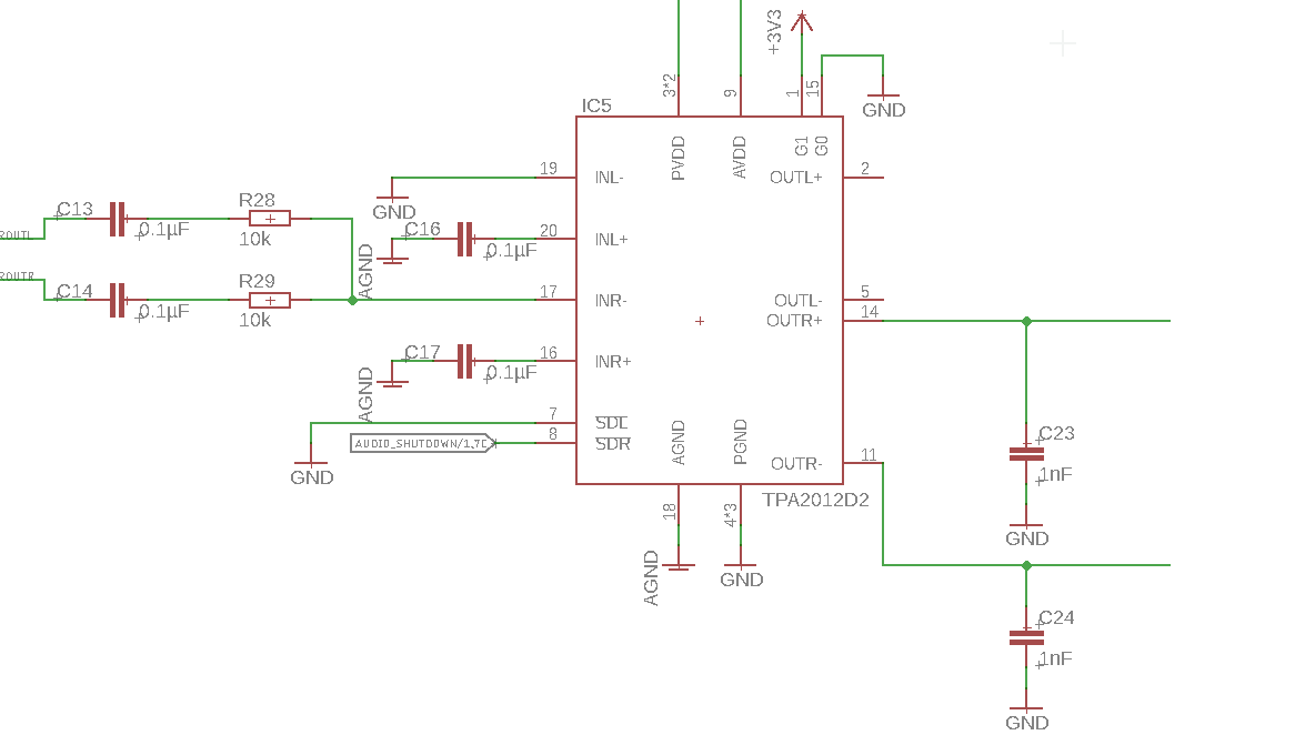

as shown in the title i use the TPA2012D2 to amplify the signal witch comes from a WL8731L Audio Codec (HPLOUT/HPROUT).
(G0 - High / G1 - Low) --> Gain (4) 4V/4V / dB 12
I coupled the input with resistors and capacitors.
Now i want to use a 8 Ohm - 1.4W Speaker but the output drives only 720mW at 3.6V
Is it possible to use both outputs for one speaker to increase the power?

    TPA2012D2 is a stereo Class-D Amplifier and a speaker can only be connected to an output.
    You can use a 5V power supply to achieve this output power level.
