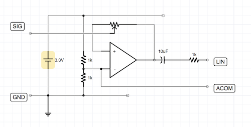

I am using the PCM2902C in an application where I am digitising am single analogue audio signal, using the left channel analogue input only.
The AC voltage range (signal) on the analogue left channel input is in the range -1V to plus 1V
When I record the signal from the CODEC with Audacity, the maximum volume appears to be only half the full range.
When I record the same signal through my PC sound card the volume is more than double.
Note: This also seems to be the case when I test with the evaluation module.
Is there anything I can do the record the full dynamic range?

  • Hi Diego,
     I tested the codec again today with Audacity, this time I hooked up my scope across V common pin 14 and V Left input  pin 12, and adjusted my pulser to just under  Vpp 2.0V.
    On the attached image you can see that the digital signal barely makes it above 0.1 on the vertical scale.
    I am using 3.3V regulated supply on pin 10 (Vcci) and VBus 5.0V on pin 3.
    The volume from my circuit is similar to the evaluation module and across both my Mac and Windows computers.
    Pulse height resolution is critical to my application , so any suggestions would be welcome.
    Steven

    Thanks for the feedback. I am wondering if this issue has something to do with the input configuration you are using. Is it possible to share your schematics?. Why are you measuring the input signal across VIN and VCOM?. Typically, a GND centered signal is provided to the analog inputs before the decoupling cap.

  • Diego,
    My circuit is simple,  just an opamp with variable gain, and has the inverting input floating at 1.65V.
    I tested the evaluation module again today with a 2V Vpp sine wave and it agreed with your test, so I figured there had to be something wrong with my circuit.
    I removed the biasing resistors on the inverting input of my opamp and this solved the problem.
    Thanks for your help.
