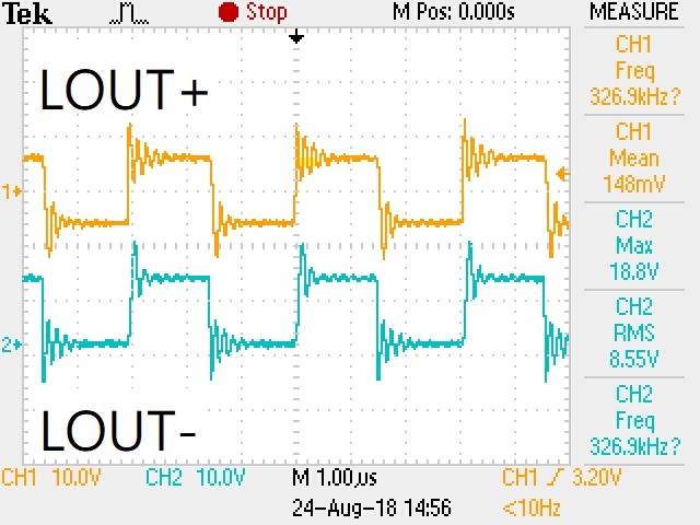

May I ask that how can we calculate the output power for the audio amp?
And if there are any document is discussing about this.
the capture output of amp is shown in attach, please let me know if there are a better way.
Thank you

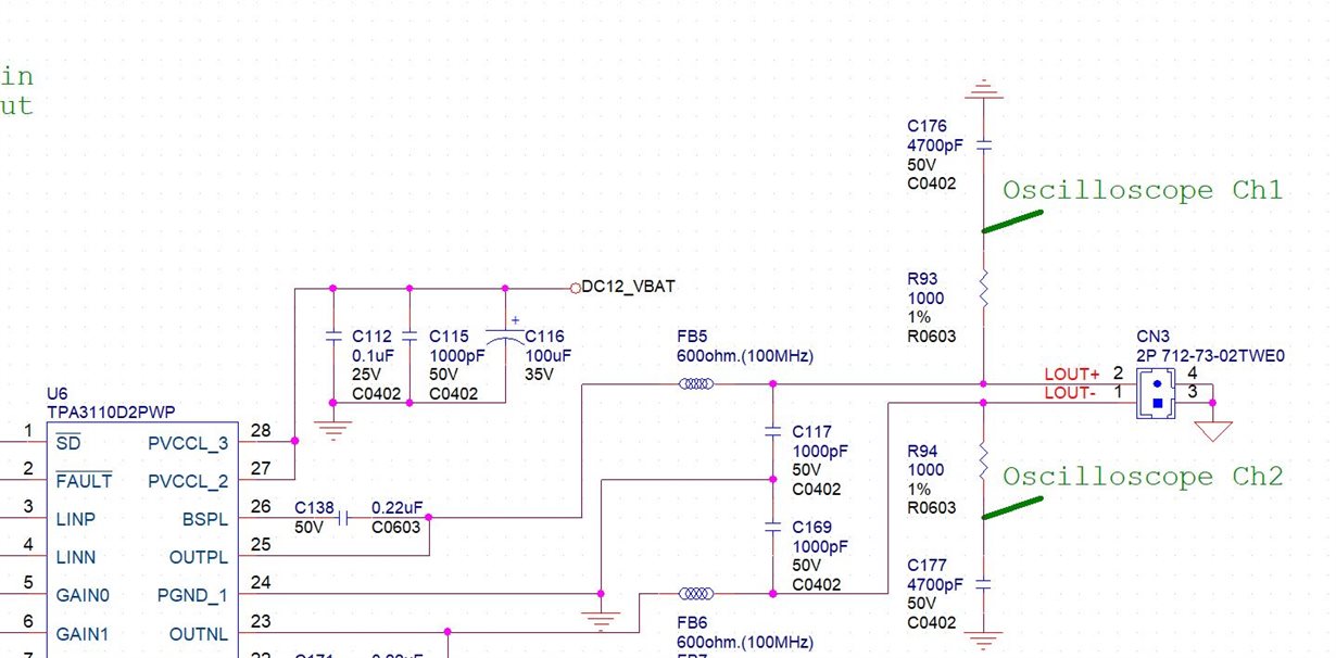

  • Hi Shawn Zheng,
          I plan to use a RC filter (1K ohm & 4700pF) on output than I will get a sine wave, based on this sine wave, I can measure the RMS and calculate the power, is it a precision result?
    webber
  • Hi Webber,
    I guess you are applying a sinewave on the AMP input. If you want a sinewave on the output, please use 22uH+0.68uF for FB5/FB6+C117/C169. With ferrite bead + cap in the output filter, you can't see the sinewave.
    Please use AP instrument to get accurate power measurement. The multimeter only gives rough result.

  • Hi Shawn,
        Thanks for your help, I have other questions, please refer to below
    1. The output power are the same between L+C filter and Bead+Cap filter, am i right?
    2. Due to I don't have 22uH, I would like use 15uH+1uF(fc = 41.1KHz) or 33uH+1uF(fc = 27.7KHz), please advise one is better? thanks.
    webber
  • Hi Webber,
    Please find my answer below:
    Q1: it depends. The sum of power comsumption on the output filter(LC or bead+cap) and the load should be close. But we only care about the power consumption on the load. So the power consumption on the load could be different between the two cases. One simple way for bead filter is to measure the RMS voltage value on the load and calculate the power consumption by U*U/R, as I mentioned above.
    Q2: For 1kHz input signal, they are both OK. Usually we prefer ~40K BW LPF for the output filter.
    Shawn Zheng

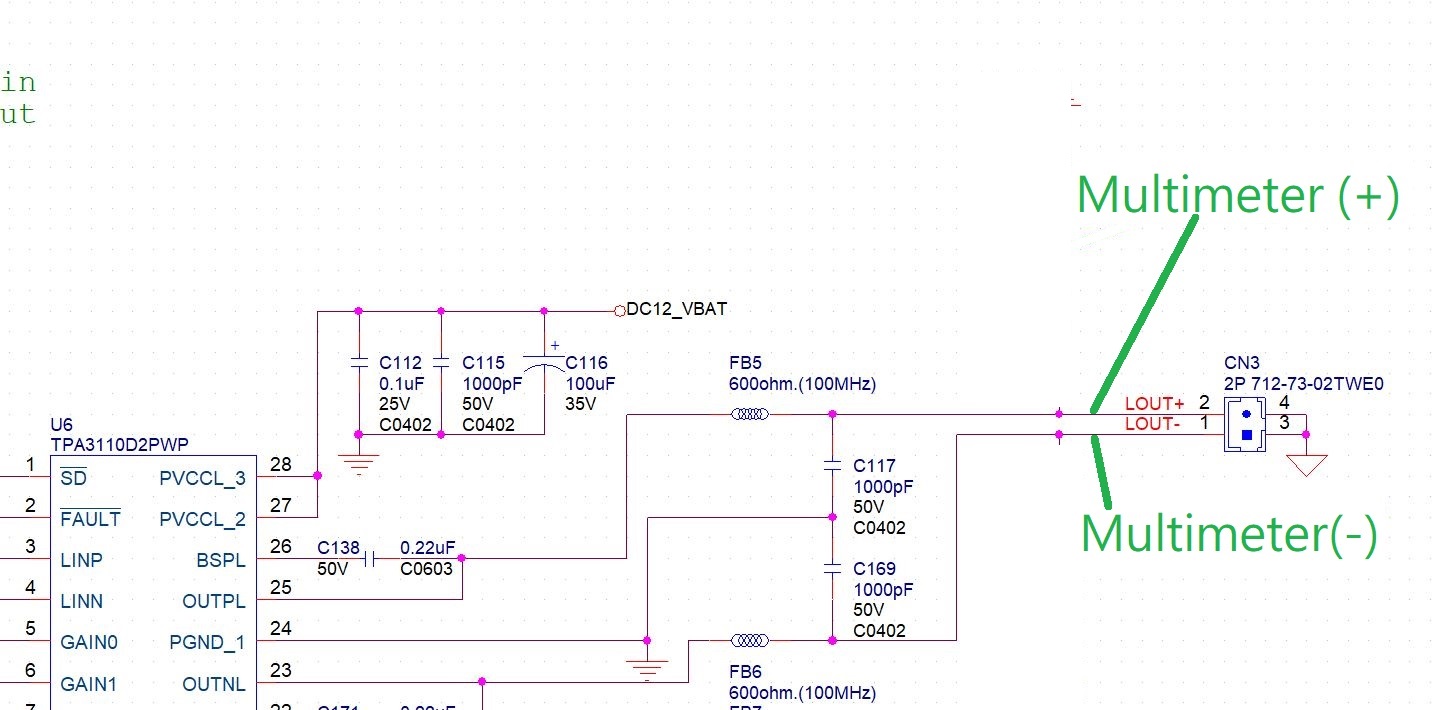

  • Hi Shawn,
        Regaridng measure the RMS voltage value on the load by multimeter, I will use the method like below photo, Am I right?
    webber
  • Hi Webber,
    Your understanding is correct.
    Shawn Zheng
  • Hi Shawn,
        Based on the test result, I can't use only Plimit to set output power, I had to limit input voltage together, for example,
    Plimit is 2V means output is around "5W", amp gain is 20 dB, Load is 4 ohm
    If input P-P is 3.44V, output RMS at load  is 6.9V-->output is 11.9W (over Plimit's setting, it's not acceptable)
    if input P-P is 1.4V, output RMS at load is 4.29V-->output is 4.6W  (it's acceptable)
    I assume that I had keep input in some range to make Plimit is working,
    Is there any formula to calculate which input is reasonalbe?
    thanks
    webber
    TPA3110D2 schematic.pdf
  • Webber,
    Please don't use the data in the Table 2 directly, it needs the totally same setup. You can calculate the voltage on the PLIIMT pin by the formula in the section 9.3.4 in the datasheet. From your SCH and description, you are using 12V PVCC and 4ohm load. right? So the voltage on the Plimit pin should be around 1.6V, but you could fine tune it.
    Please be noted that the PLIMIT fucntion is a very rough protect on the speaker. It only limits the virtual power rail to limit the output power. You have to limit the input signal amplitude to protect the speaker.
    Shawn Zheng
