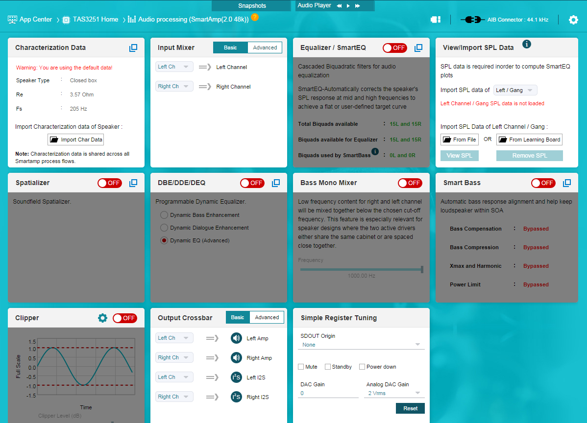

My TAS3251EVM is not working. The configuration I set for the TAS3251EVM is as below:
  1. TAS3251EVM as slave device (I2S)
  2. The I2S master is from my ADAU1701 (Master) - providing the MCLK, BCLK, SDIN and LRCK to the TAS3251EVM
  3. J37 - OUT (AIB I2S)
  4. J30 - SDOUT
And my Purepath3 config is as shown in the image below:
I manage to play the sound from the Checking and the USB (playing a mp3), but cannot get the I2S to work. Please advice. Thanks in advance!

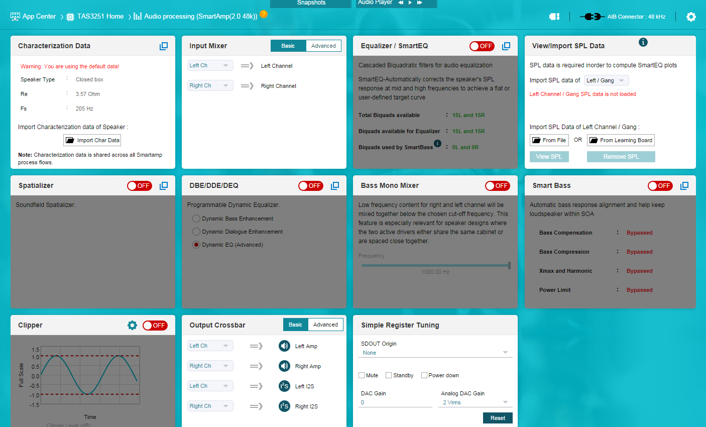

    I managed to get it work. I was too young, too simple, too dump to use it at first. Basically, what I did is as shown below:
    1. TAS3251EVM On-Board Setting
      - Refer to the picture below
      - Make sure it's under Master Mode (Even though your TAS3251EVM is acting as slave for the I2S Side)
        -> J35 - open/OUT
        -> J22 - Master Mode
        -> J37 - open/OUT
    2. Purepath 3 Setting
      - Choose the AIB Connector
      - The Sampling Frequency depends on your I2S Master (My Case: 44.1kHz)
      - I try to upload the PP3 setting into a file for you to test out as well
      My Purepath 3 Setting File (Just Open it in your Purepath 3)
      classD.zip
    3. I2S Input - Oh yeah, GND!
      - Refer to this link for the schematic: - Find out the J28 Connector Part => EXTERNAL I2S (AIB)
      - For who too lazy to find, please refer to the image below for reference
      - Make sure your I2S Master GND and the TAS3251EVM GND are connected!
      Well, everything should work out right now~ Cheers!
