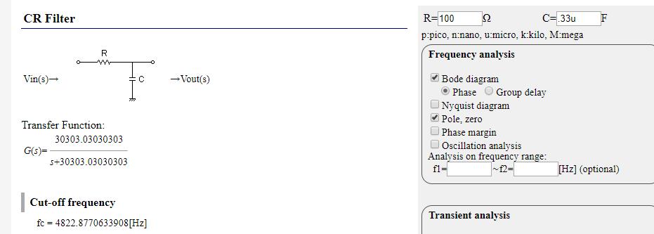

      How to reduce the volume of audio high frequency ,and keep the audio low frequency at the same time ?
