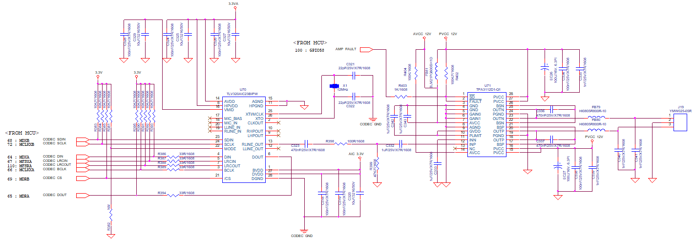

Dears:
Customer use TMS320F28335(McBSP) to control TLV320AIC23B-Q1
The sound source is in the memory(MP3 format) , and want to output this sound source to about 20W through Codec. is it OK? Or other PN to realize the function?
Could you kindly help to check the schematic, and give some advice about it?
  • Lian,
    The pullup resistors for the I2C lines are pretty weak. I might suggest 2.7-4.7k instead. Which I2C mode is the customer planning on using?
    The I2S lines shouldn't need any pullup resistors.
    What is DOUT being used for? I don't see any analog inputs.
