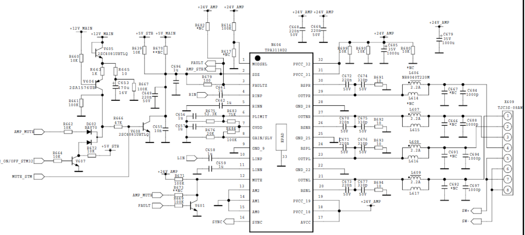

Dear  All

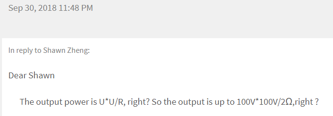

       My speaker spec is 8Ω, but when the video input is high frequence, like 14KHz,the speaker load will change to 2Ω, the voltage of OUTNR with OUTNL will change to 100V, Why ? The normal voltage is 40V in 8Ω.
       I had set the GAIN/SLV pin to 20W, the maximum output power is 20W,right?
