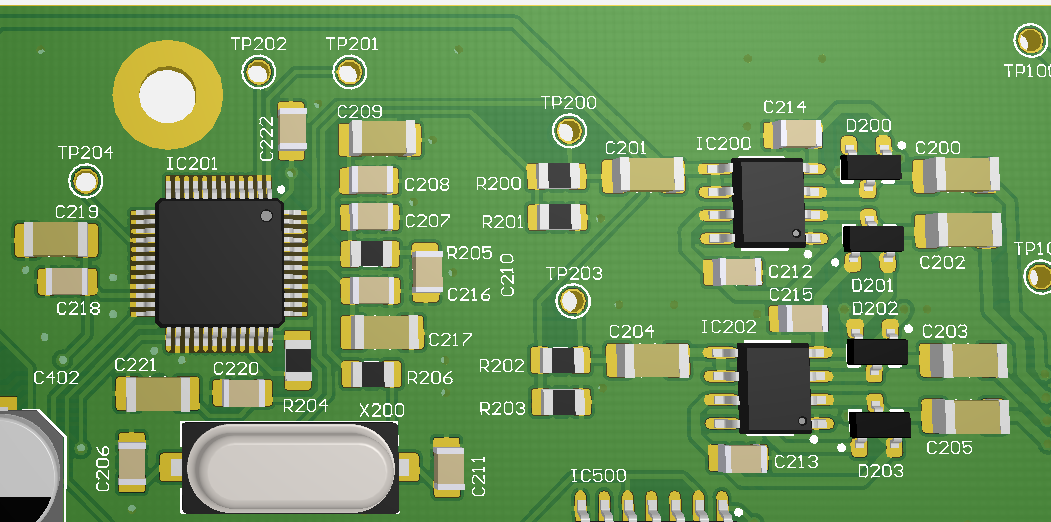

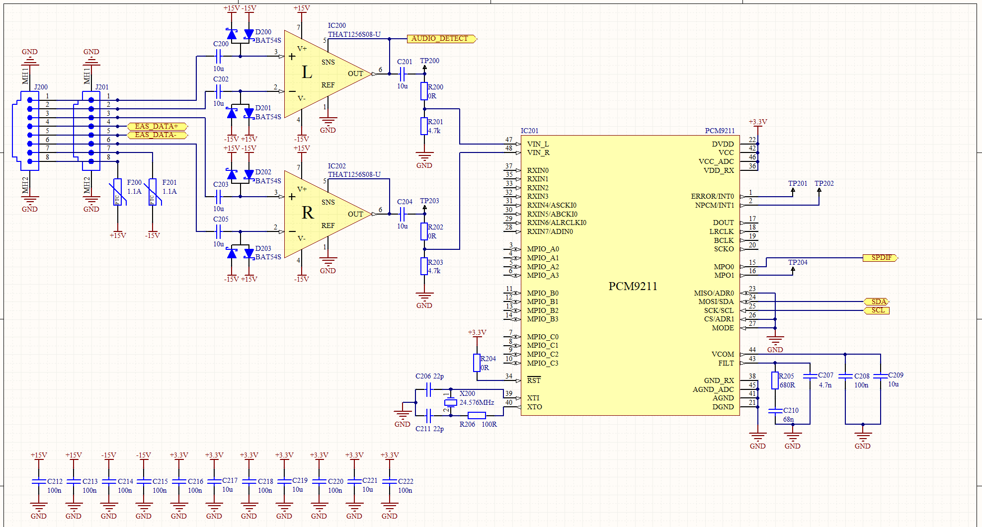

I'm pretty sure it's nothing wrong with my code. I've modifyed my PCM9211-EVM board so I can control this with a microcontroller, and this board works perfectly fine with the exact same program as I run on my custom designed board. I'm also qiute sure it isn't the Toslink connector either, because I've also tried to desolder the one from the PCM9211-EVM board and use that one instead, but without any futher sucess (still white noise).
Here's a list of the current mods I've tried so far:
* Replaced the 100R current limiting resisitor on the crustal with a 0R one
* Replaced the 22p capacitors on the crystal with 10p ones
* Replace the 0R pullup resistor on pin 34 with a 10k one
* Connect all MPIO and RXIN pins to ground
Have anyone experiences this issue before?

Here's a photo of the PCB laypot around the PCM9211:
Here's the schematic sheet for it. Note that the decoupling capacitors (100n and 10u) are located very close to the power and ground pins with short ground return paths. the entire underside of the board is a solid ground plane.
