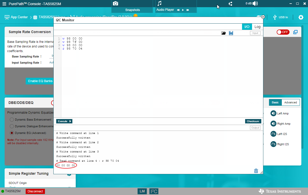

    We are seeing Clock Fault conditions when using the PUREPATH-CMBEVM Rev D, PCB No. AIP006G along with the TAS5825MEVM Rev D, PCB No. AMPS023A. When this happens, I use the PPCM Register Map tool and see that the Global Fault 1 register (Address 0x71), bit-2 = 1. This indicates a Clock Fault. We see this sometimes on power up or when it is being used. This issue exists when using USB audio input and when using the Analog Input path.
    What conditions should we be looking for that might be causing this fault?
    Should we continue this discussion in this E3E case, or should I submit a separate E2E support request for this issue?
    Thank you for your help.
    John Pierson
  • Hi John,
    Do you use the PPC3 to initialize the TAS5825M device? I don't see any fault detected in the PPC3 GUI.
    Usually, when the TAS5825M goes into the play mode, its clock monitoring circuitry will start to monitor the incoming clocks. If one or more of the following errors occurs, the clock fault will be reported in the Register 0x71.
    1) Non-Supported SCLK to LRCK Ratio
    2) Non-Supported LRCK rate
    3) SCLK or LRCK has stopped
    You can remove this clock fault by writing to the Register 0x78. However, if the fault condition continues, the same fault will be reported again.
