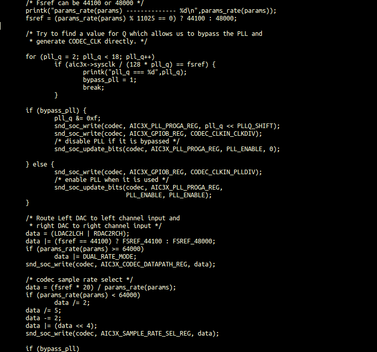

 Hi Team,
I am using TLV320aic3105 codec for our custom board. Working on 96 Khz sample rate for 24/16 bit. I have gone through the driver code (tlv320aic3x.c), there is only 48Khz/44.1Khz sample rate support, but not for 96Khz.   i tried changing pll_q=4, able to hear some audio, but not clearly  and also BCLK is not correct.  Below I have given below the snap shot of the driver calculation.
Could you please help me in this regard.
