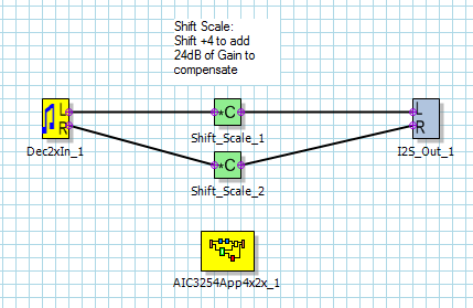

We are testing a 192kHz sample rate through the miniDSP. We trying to configure the use of FIlter B which will introduce a -24dB gain error which will supposedly be fixed by a +4 shift (more info further). The AIC3254 is on a product in which I have i2c communication (via) DSP Driver and a McASP interface between the AIC3254 and the DSP. We thus interpret pps driver files register settings and configure the codec without a EVM board via i2c.
Attempting to replicate something similar to this post
AS SOON AS I CONFIGURE THE USE OF THE miniDSP_A the ADC samples are all zero.
I have been trying to configure the miniDSP for a simple process flow as below:
The Framework used is not the default 192kHz framwork as I would like to use Filter B for the bandwidth, the framwork used I assume uses filter B.
The process flow is setup as below:
With the SystemSettings code edited as follows:
(I am commenting out all the DAC settings as for now I only want to get the ADC running through the miniDSP, Is this fine?)
(I have also commented out any initialization, power up, routing and clock setup as this is done in the miniDSP driver, I will provide details further)

As shown above the following are some highlighted configuration settings (are they correct)?
Clock Settings:
PLL is used = 98.304MHZ = CODEC_CLKIN
NADC = 2
MADC = 8
AOSR = 32
CODEC_CLKIN = NADC x MADC x ADC_FS = 2 x 4x 192000 = 98.304MHZ (Is this correct?)
I see in the clock distribution tree there is an indication that the mini DSP clock generation branches off after the NADC does this still mean my clock setup is correct, is it somewhat confusing to me?
Also in the reference post they use 2x decimation, Im not exactly sure why and where this 2x decimation comes from as I was under the impression the decimation is done with the hardware filters (Filter C) before the miniDSP based on the framework. How does it fit in with the clock rate settings and sample rate?
I have attached the process flow in case it is needed:
TC5 Test 2.zip
  • Hi, Miguel,
    As you  commented some of the initialization registers for the codec, I wonder if there is a problem with the device configuration as typically the sequence followed in system settings code should be followed. Have you tried to run the application with the complete systems settings code?. The decimation filter when the miniDSP is used actually is determined by the Decimation block, which should match the framework selected.
    I will take a look to your process flow and settings in detail, but it may take me some time to experiment on my end, so appreciate your patience in advance.
      -Diego Meléndez López
       Audio Applications Engineer
  • Hi Diego,
    Thank you for your reply.
    I have not, although the CODEC is running perfectly until I "USE MINI DSP" so I am quite sure that the initialization and power up is correct and functioning?
    Thank you for looking at the process flow I look forward to your response.
    Kind regards
    Miguel
  • Hi Diego, any progress on getting the process flow up and running?
  • Hi Diego,
    I am still not able to get the audio through the miniDSP. Are you still trying to find time to look at the process flow in more detail?
  • Miguel,
    Sorry for the delay, was swamped lately and missed this one. I loaded your process flow in the EVM and noticed that the System settings code is not commented in the .PFW file. I downloaded that code into the EVM and I can see the ADC output in DOUT. Then, I tried loading the system settings code you shared in this post after a HW reset on the device and the ADC output (DOUT) is lost. I noticed you are commenting not only the initialization registers, but also the ADC and PLL configuration registers, which is not right, After un-commenting those lines, I got DOUT signal back. Please refer to below System Settings code I used:

  • Hi Diego
    RE: " I noticed you are commenting not only the initialization registers, but also the ADC and PLL configuration registers, which is not right"
    If you look in my initial question I detailed some of the ADC and PLL settings (which is why I comment out the process flow setup - I am not using the EVM).
    Clock Settings:
    NADC = 2
    MADC = 8
    AOSR = 32
    To provide a bigger picture the PLL is setup as follows:
    The PLL Uses the MCLK at 14.7456MHz.
    R = 1
    P = 3
    J.D = 20.0
    This setup is currently being used without the miniDSP and is working correctly.
    I have tried with NADC = 4 and MADC = 4 (setup w/o miniDSP)  AND  NADC = 2 and MADC = 8 to no success.
    Looking at this tree I see that the miniDSP gets its clock after the NADC divider.
    WHat exactly should the clock rate be for the miniDSP? Maybe my problem lies somewhere here?
    Best Regards
    Miguel

  • Hi Diego
    Thank you for your response. Below please find the configuration below, I hope it is understandable:
    FORMAT:
    AIC3254_PAGE_X,               0xXX                                          , 0xXX
    PAGE_0                 ,              Register Number(HEX)             , Register Value(HEX)
    // Setup the clock multiplexers:
    // - Low PLL clock range
    // - PLL input clock is MCLK
    // - CODEC_CLKIN = PLL Clock
    AIC3254_PAGE_0, 0x04, 0x03
    // - Choose R = 1 and P = 3
    // - Calculate J.D = 20.0 --> J = 20 and D = 0
    // - This results in a PLL_CLK of 98.304 MHz
    // Program PLL P and R values and power-up PLL
    PAGE_0, 0x05, 0xB1
    // Program PLL J value
    AIC3254_PAGE_0, 0x06, 0x14
    // Program PLL D value
    AIC3254_PAGE_0, 0x07, 0x00 MSB
    AIC3254_PAGE_0, 0x08, 0x00 LSB
    // Configure the input channel (ADC)
    // Setup NADC and power-up divider
    // NADC = 4
    AIC3254_PAGE_0, 0x12, 0x84
    // Setup MADC and power-up divider
    AIC3254_PAGE_0, 0x13, 0x84
    // Setup AOSR = 32
    AIC3254_PAGE_0, 0x14, 0x20
    RE: The ADCs being turned ON
    Yes the ADC is configured elsewhere. A confirmation of this is that if I simply switch the Register which Enables the use of the miniDSP to not use it, then the ADC samples as expected.
    Here is the power up config:
    AIC3254_PAGE_0,   0x51 ,    0xC0
    Thank you very much for your assistance in this regard.
    Miguel
