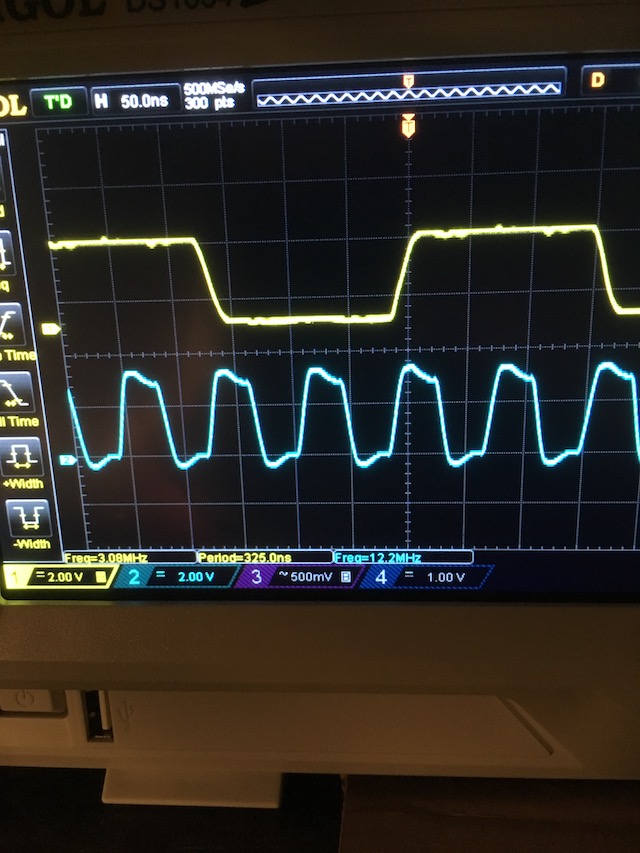

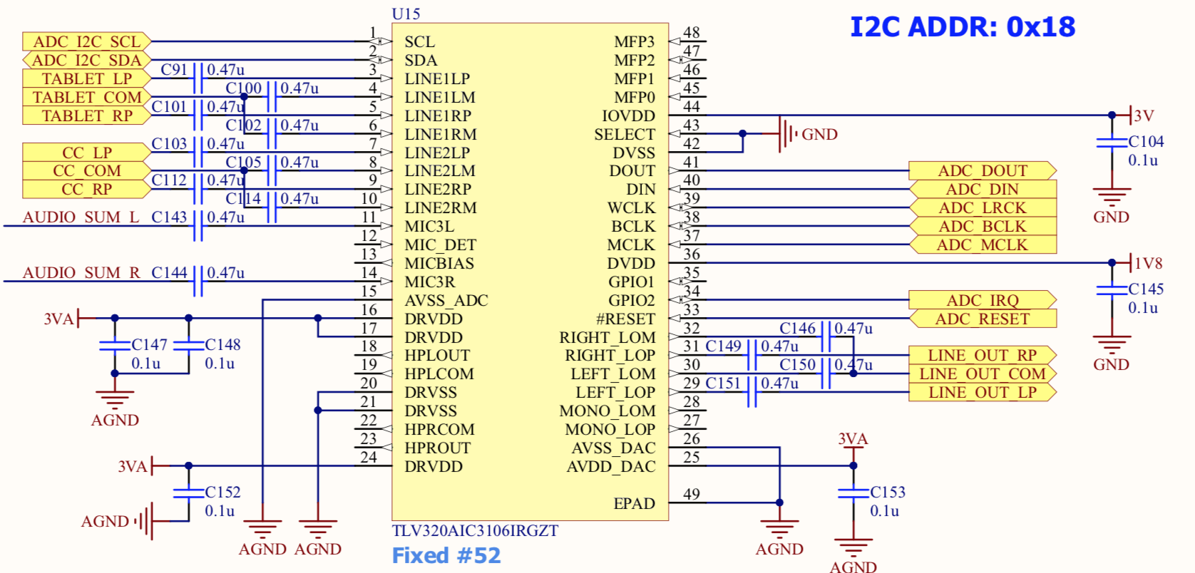

I am running the TLV320AIC3106 from the ADC to an MCU over I2S. The MCU then mirrors the data back on the I2S to the TLV320AIC3106's DAC. I am puzzled by the behavior because sometimes when I start it up it works really well but most times I start the chip there is significant distortion in the output.
I have narrowed it down to how the ADC is being configured. The DAC seems to be working and I have verified with a separate I2S amp that the distortion is part of the ADC's output I2S stream.
The code below is what I use to configure the part. The I2S is running at 32-bit 48KHz with a 48KHz*256 mclk into the part. I get similar results whether I am using the MCLK with CLKDIV or using the PLL. One difference is that when I run the PLL I have to clear the lower 3 bits of register 9 or I hear nothing at all. If I clear only bit 0 of register 9, I get static. That is just with the PLL on. With the PLL off, The bottom 3 bits of register 9 don't seem to have much effect.
At this point, I have tweaked about everything I can think of. The issue seems to be with the clock so I included some scope shots below of the master and bit clocks as they go into the codec. I can't figure out if I am configuring something wrong or have a problem with signal integrity (or maybe power supply bring up?).
Thanks!

Here is a shot of the bit and master clocks as they are going into the codec.
