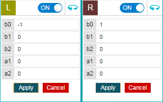

Hi Kato-san and Shawn,
I checked cross bar block last week. I did not want to swap left and right channel. the design need to swap the left + and left -.
I have no idea how cross bar can achieve. Please kindly provide your comment for details.
Thanks for help.
SHH
Hi Scott-san,
Advanced setting of Output Crossbar tab has an AMP Post EQ settings too.
Perhaps you can invert the L-ch output polarity by PPC settings as below. But I did not test this.
1. Turning on AMP Post EQ.
2. Turning off Gang Biquads check box in AMP EQ page upper right.
Not only L-ch but also R-ch biquad setting tab might be appeared at bottom left side.
4. Turning on L and R biquads.
5. Setting both biquads filter type to custom.
6. Setting coefficents as below.
L-ch: b0=-1, b1=0, b2=0, a1=0, a2=0
R-ch: b0=1, b1=0, b2=0, a1=0, a2=0
7. Clicking both Apply buttons.
