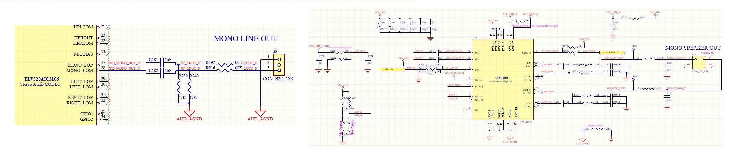

TPA3111D1: Line Out from TLV320AIC3106 is to be amplified to drive 30W 8ohm speaker- Reference GND to be used?
Part Number: TPA3111D1
Other Parts Discussed in Thread: TLV320AIC3106
We wanted to amplify the line out signal generated using TLV320AIC3106 to drive 30W 8E speaker(we donot want to use full power out speaker, so 10W amp used).
I've some confusion regarding the GND connections.
Please check the image of schematics below and let me know if it is fine.
Thanks in advance.
