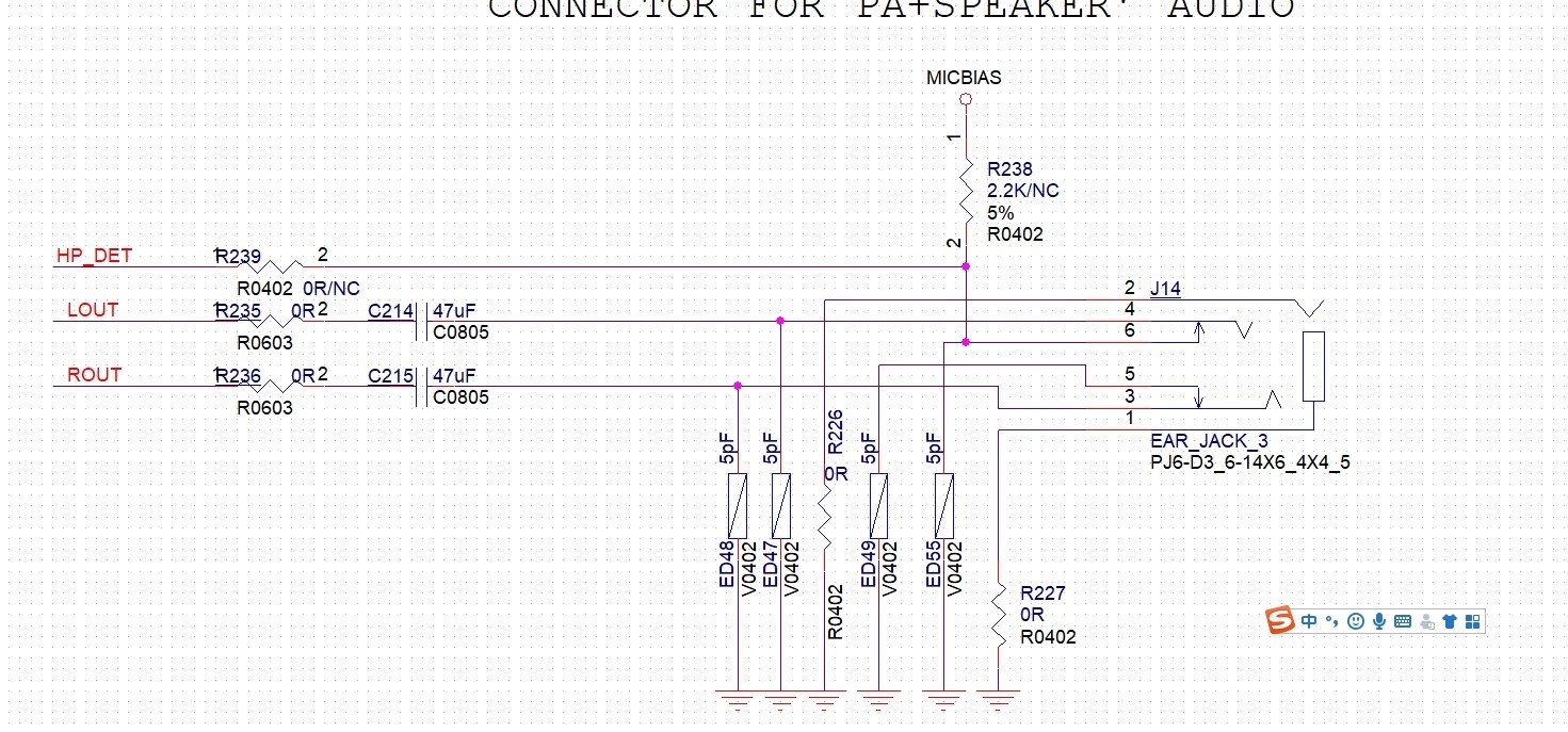

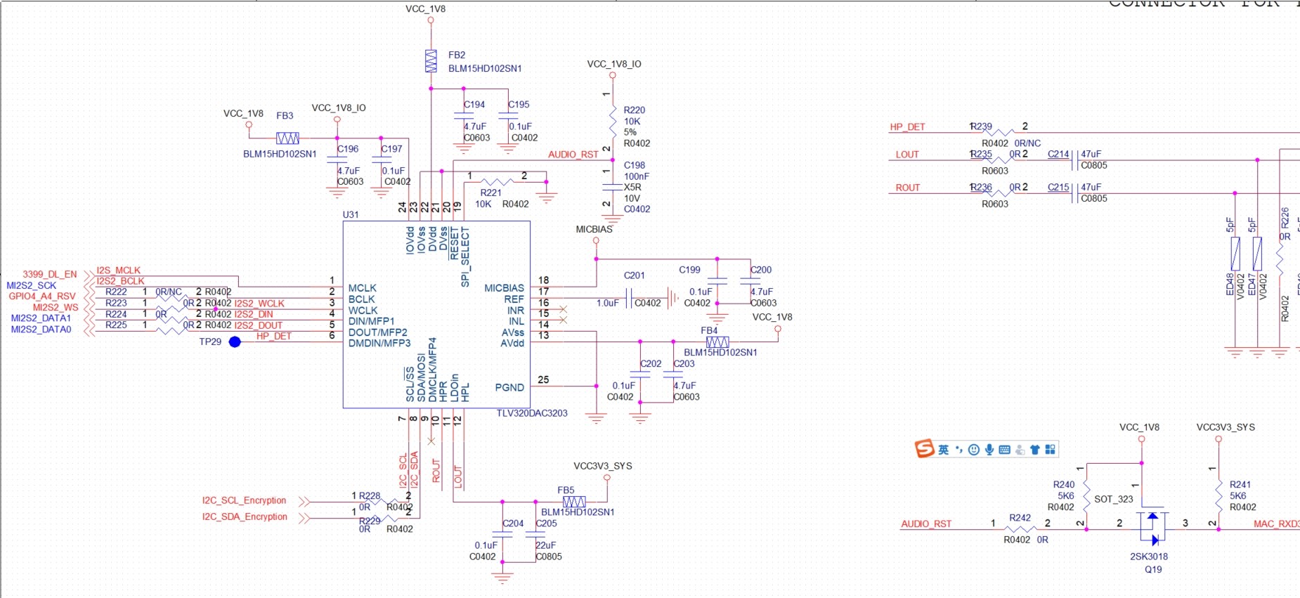

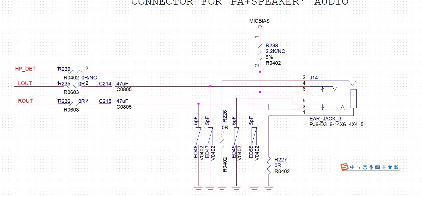

Dears:
Could you kindly help to give some advice about the POP issue.
Since there will happen POP sound when power on.
The below picture is the shechmatic:

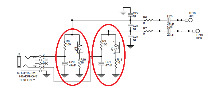

  • Hi, Luck,
    Thank you for sharing the details about the registers configuration.
    I tried with these registers settings on the TLV320DAC3203EVM-K evaluation board.  I have few suggestions for customer:
    - Could he try removing the ED47, ED48, ED49, ED55 components from the circuit?
    - In addition, could he try adding an output filter like the one shown below? The 16ohm resistor to GND (R10 & R11 in picture below) is useful to avoid pop cases.
    Please let me know if the problem persists.
