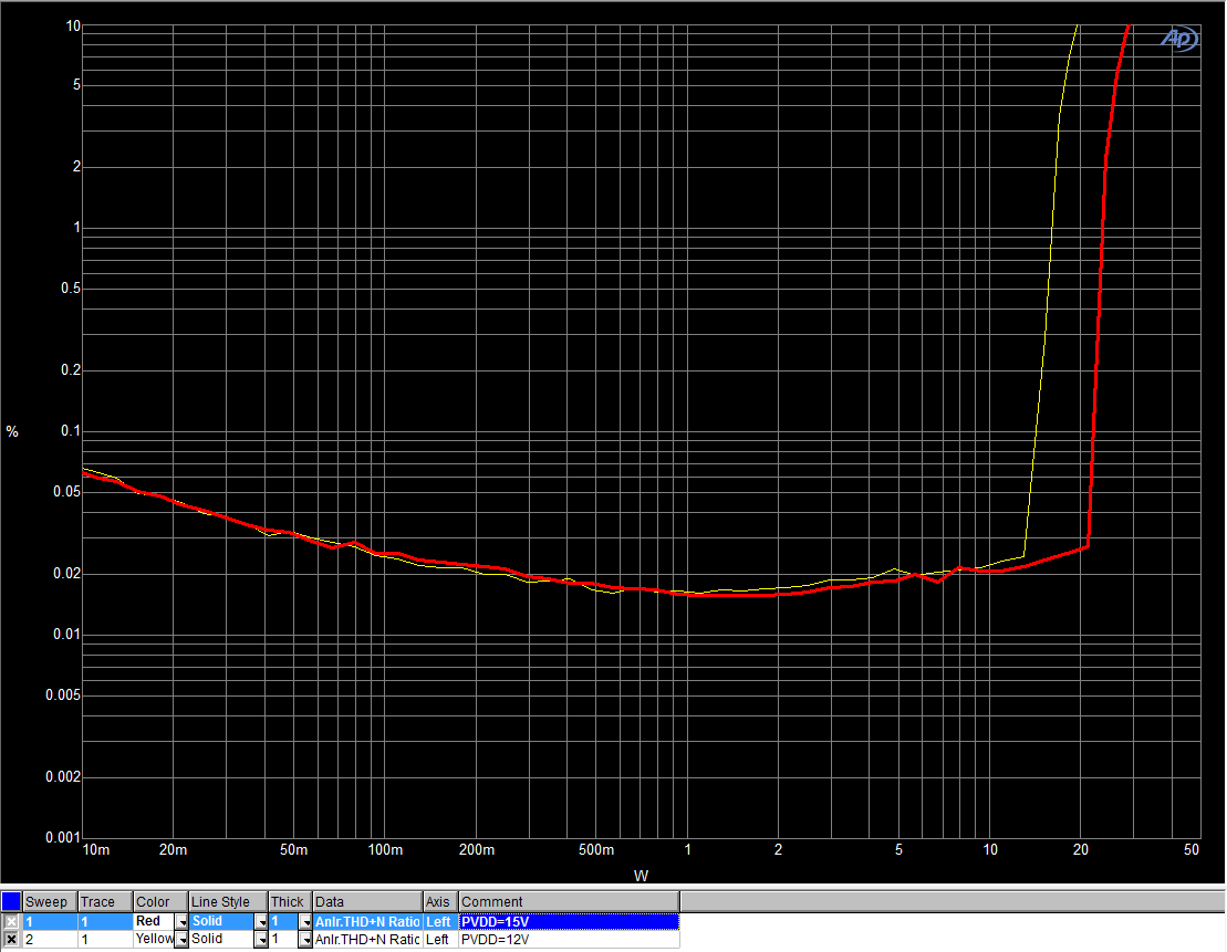

My customer is considering using TAS5720A-Q1 for AVAS(Acoustic Vehicle Alert System) in automotive application.
This team asked some questions about the TAS5720A-Q1 as below. Would you please reply with relevant measurement data?

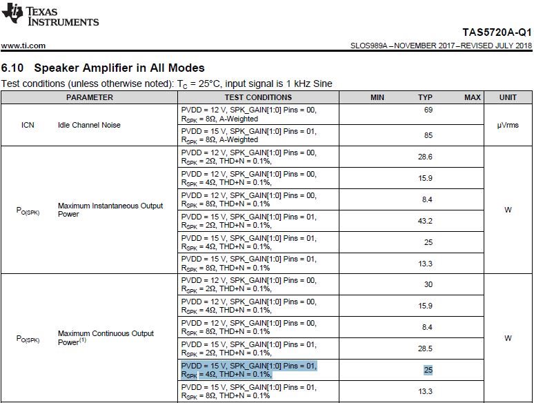

1. What's the maximum output power @ PVDD=15V, 4 ohm load, THD+N=10 %?
    Because the TAS5720A-Q1 datasheet has THD+N=0.1 % condition only as below.

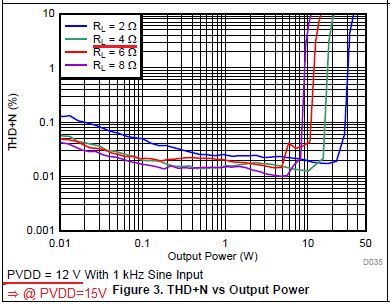

2. Do you have any electrical characteristic graph for THD+N vs Output Power @ PVDD=15V With 1 kHz Sine Input, 4 ohm load conditions?
    Because the TAS5720A-Q1 datasheet has the graph, but the PVDD=12V as capture below. So my customer want to know how much differences @ PVDD=12V vs PVDD=15V.
