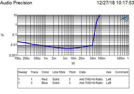

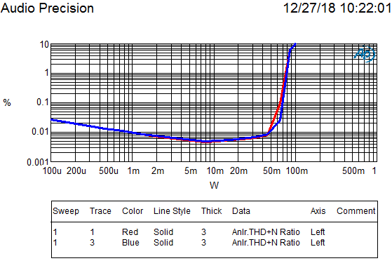

We are promoting TPA6130 at one AA, and could you kindly help us check below two questions?
1. the output power curve with 3.3V power supply, but we only have the power curve of 2.5V, 3V 3.6V and 5V, so whether we can support the output power curve with 3.3V power supply. Since the speaker's spec haas not fixed yet, maybe they will use 24ohm or 32ohm speaker.
2. customer will use 10uF DC block cap since to reduce the phase shift of low input signal, so it maybe has pop noise issue if the charging time of DC blocking cap is larger than the power on delay time, so what's the charging current spec of DC blocking cap, and do we have the recommended range about this cap?
