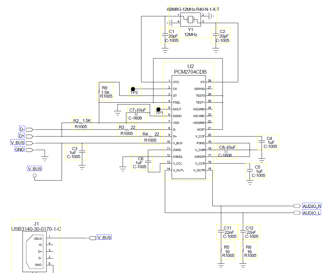

hello. TI team.
When using the internal Vdd(3.3V), 3.3V drops to 2.5V for 3 second. At 2.5V, audio out is cut off and the voltage returns to 3.3V.
When using external 3.3V, it operates normally.
Should I use an external 3.3V?
Can you see why voltage drops when using 3.3V internal?
