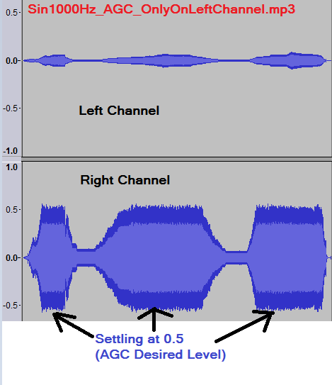

I have a digital MEMS microphone connected to GPI1 on the TLV320AIC3262.
I'm trying to apply automatic gain control (AGC) to normalise the captured speech to amplify when it's quiet or to reduce when it's peaking/clipping.
The problem is that my AGC configuration (PPS file attached) is having no effect at all.
If you open the example audio files attached in Audacity you can see the AGC isn't modifying the audio level.
Example 1 = quiet 1khz reference tone with changing amplitude; the AGC does not amplify;
Example 2 = loud spoken word, the AGC does not reduce gain;
What is wrong with the AGC configuration? Why does it not adjust the gain to the given target level? Is it not applying to GPI1?

    It appears that the AGC configuration is applying a uniform 16dB of gain, which is insufficient gain for quiet voices while introducing distortion for loud voices.
    What we want to achieve is a consistent audio level whether the person is speaking quietly or loudly, and whether they are speaking close or far from the microphone.

    Attached are two new audio files which were captured with the exact configuration files previously supplied.
    It's particularly visible in the sine wave recording that the AGC isn't adjusting the gain when the amplitude of the signal through the microphone increases/falls.
    Thanks.

    I have attached a slightly modified version of your process flow. The only modification is that it routes the AGC input on the right I2S channel so that both the AGC output and input can be captured simultaneously.
    Could you use the modified flow, repeat the sine test and loud-sound test and send me the recordings ?

    With respect to the output file that you uploaded, Sin1000Hz_AGC_OnlyOnLeftChannel.mp3, I can see that the left channel has low level audio with peaks around -24 dB. The output levels in the right channel are higher and the peak level is around 0.5 (or -6 dB).
    The programmed settling value of AGC_DESIRED_THRESHOLD in the AGC component is 0.5. Please refer to graphic. The settling behavior of the signal in the right channel is also at 0.5. This resembles the expected behavior of the AGC. In the process flow that I shared, the left channel recording should have contained the AGC output and the right channel should have contained the AGC input. Therefore the indications are that there is channel swap in the file that you have shared. If we assume a channel swap, then the AGC appears to be settling at the correct level.
    I also ran a separate experiment using the left channel as input and passed it through the AGC and the output file envelope matches the envelope of the right channel. Therefore, I request you to check if there is a swap in the channel assignments in your recording software.
