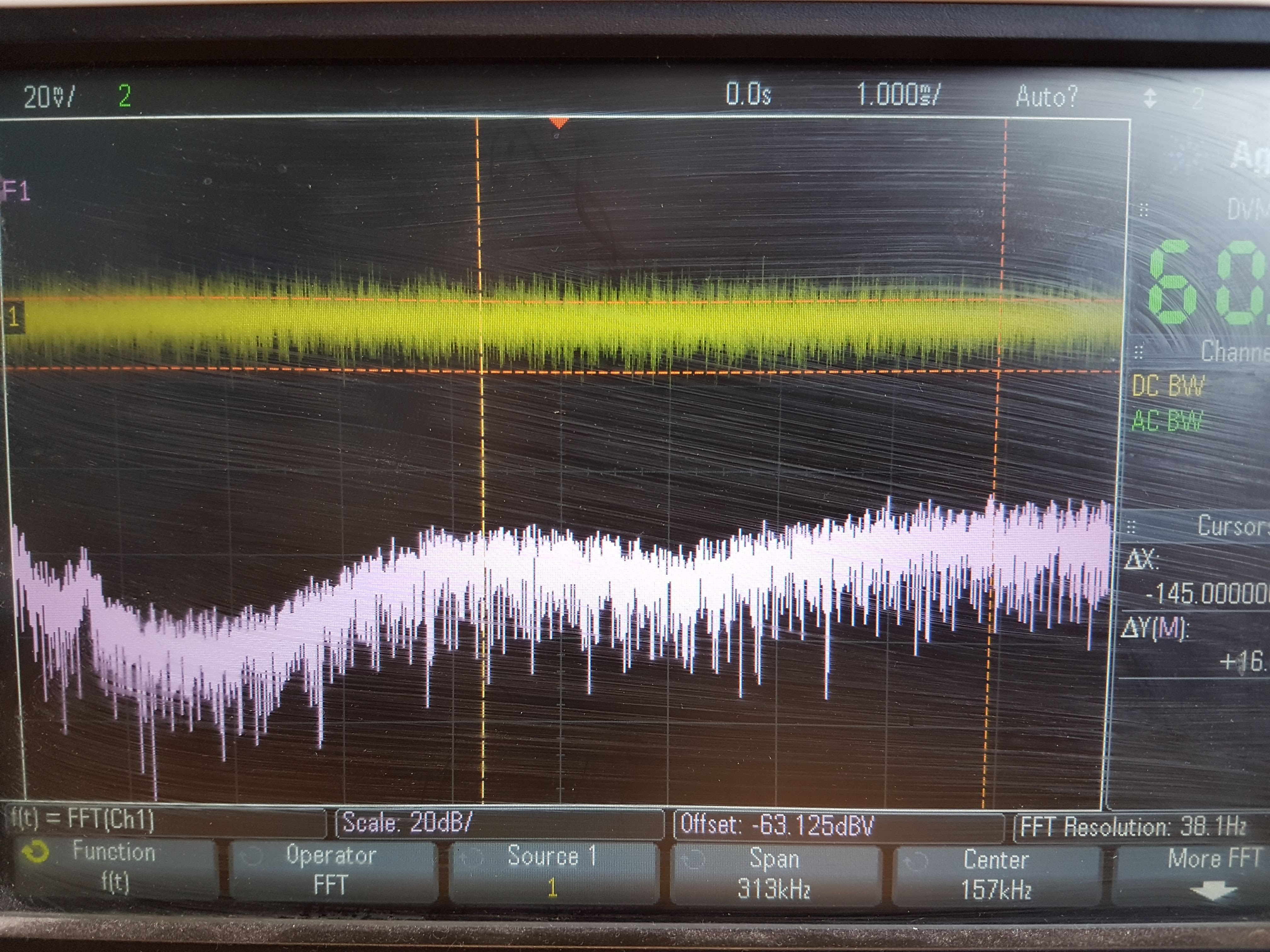

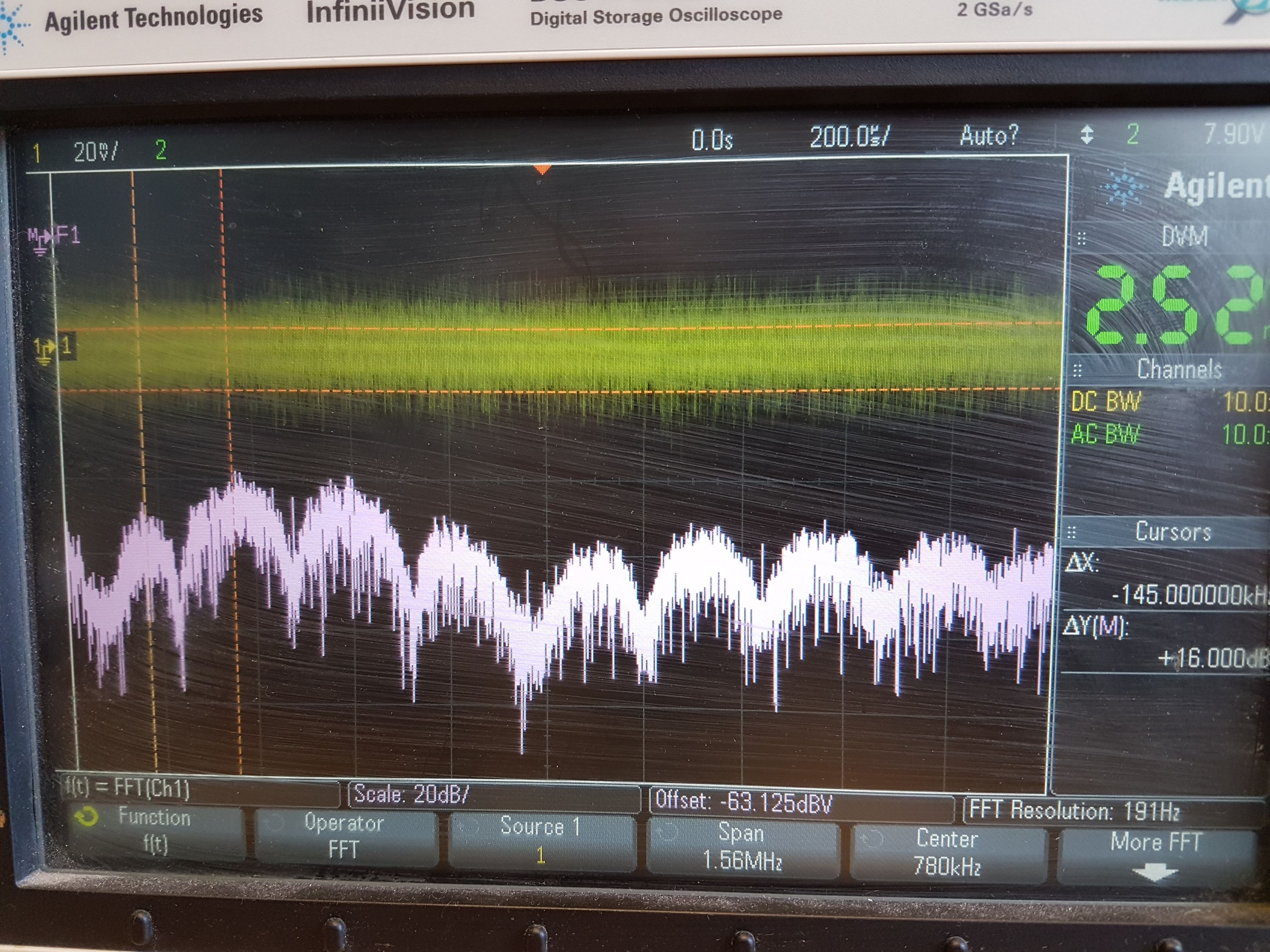

    Below are some screenshots of the Macbook output and FFT. There is no noise problem with other portable speakers I've tested with. So it's either a lack of filtering (which should be covered and advised in your documentation) or a problem with the ADC settings.
    I hope you can offer a solution. The audible noise is VERY bad - David

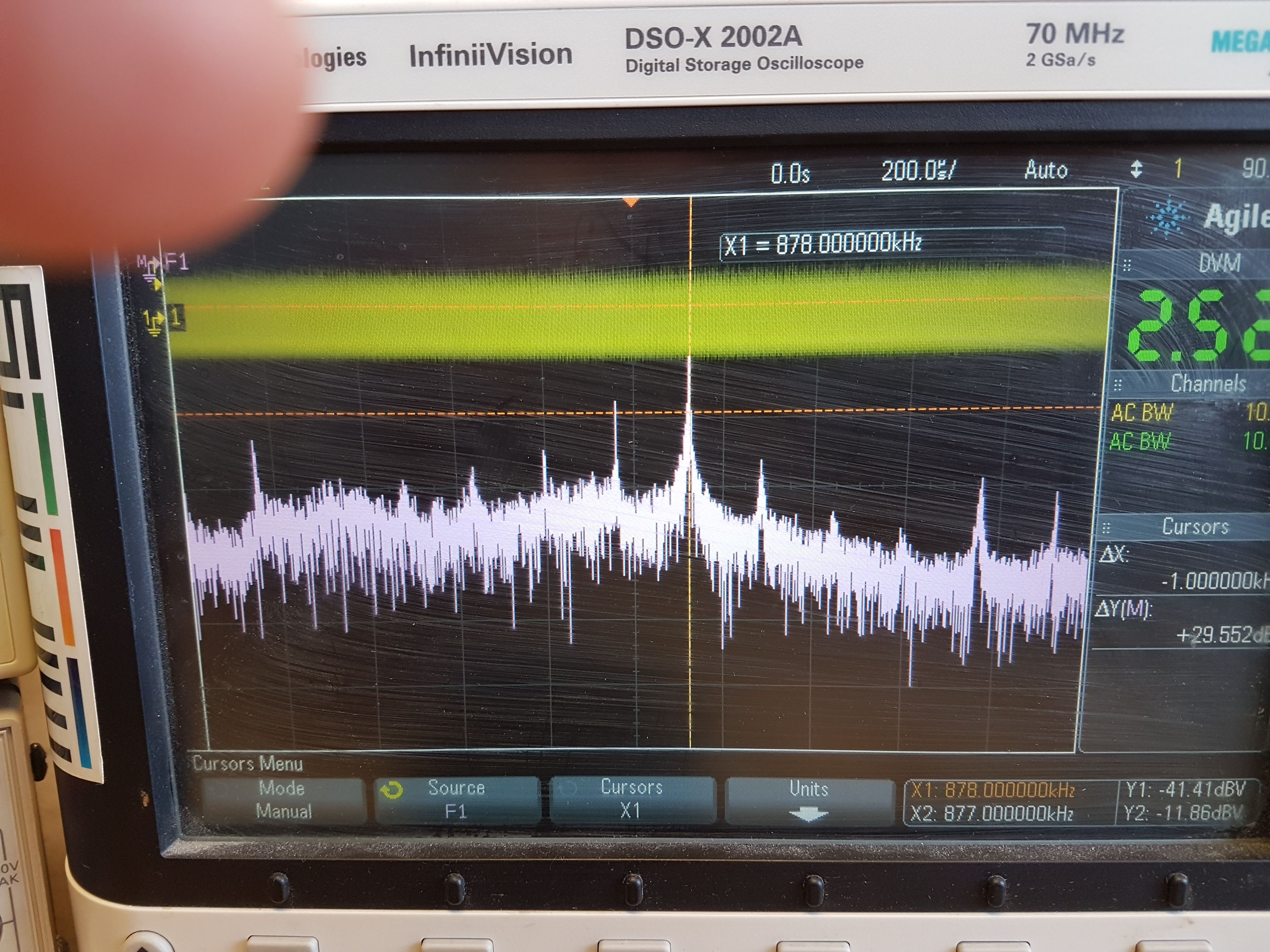

  • I have done some more investigating. I tried the EVM and the audible noise wasn't there. So I started looking and what additional components there were on the ADC inputs in my circuit compared to the EVM. I started removing components until I found the cultrit.
    It was a 10nF capacitor I place between the jack audio inputs and ground for ESD/EMC/EMI purposes.
    I placed two 10nF capacitors between IN1L and ground and IN1R and ground on the EVM (after the 1uF caps this time) and exactly the same noise was heard. It seems to be creating an oscillation at 877kHz. Its so strange, it doesn't occur with any other phones or music sources and these caps have never caused a problem before. Obviously moving forward I will change/remove this cap. But is there anything I can do in software to fix this?
    Here is how the FFT and noise changes when the caps are added.
