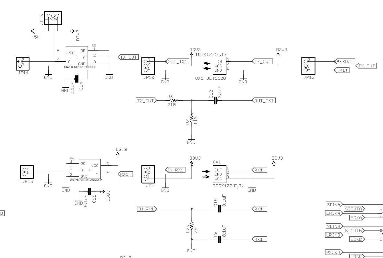

I'm trying to get the SRC4392 to work properly on my design. Using port A and or B as slave ports there is no problem to get them on TX output, coax and optical. Even passtrought from A to B I2S works.
There is a microcontroller that controls all the I2C stuff for the SRC4392, unfortunately, I'm stuck somewhere with the inputs. There is no way to make them work, neither doing a DIR-DIT bypass. I tried to follow some forum explanations on the init code, but no luck. This is my init routine:

But no luck, only works when selecting input from Port A or B. Audio input sample rate is the same as used on MCLK and RXCKI clocks, so should work.. but nothing.
This is my input/output schematic, just in case there's something wrong.. (I don't think so anyway):
I also have another question regarding sample rate input detection. My design has two clocks for 44.1 and 48 sample rate frequencies. I can switch them separately on/off and use one or another separately for MCLK and RXCKI. How can I aut-detect the input sample rate to switch between RXCKI 22.5792 or 24.576 clock?

  • Dear Ravi,
    This actually works, thank you! But actually found the real problem, the buffer used for TTL input was forcing low the optical input, really weird... after desoldering buffer, works like a charm.. It's really strange this happens, to me my schematic looks good.
    I need to use both TTL and optical inputs at "same" time, that tmeans that user no needs to use jumpers or something similar. Any help on this?

    Thank you so much for your response. Unfortunately I think you have not understood correctly my question, or probably I was not so clear explaining the situation!
    The design has 4 optical inputs, that also allows to use coax if user wants to use it instead of optical input. So coax and optical shares same RX input, of course! User obviously cannot connect Optical and Coax at same time, I just want to give the user the possibility to use the one he/she wants.
    So, in addition, there are four TTL inputs, that user can also use in case don't want to use Optical or Coaxial. Or just because the user requeriment matches using TTL inputs.
    Now the problem here relays that TTL buffer is forcing low the RX inputs, so that's why I was not able to get Optical and Coax inputs working. When desoldered buffers from the board, inputs start to work.
    So just asking why I'm having this behaviour on the buffer, because there's should be no problem at all with that (you can check my design above with input buffers). Input is floating, bout output shoudn't be forced to zero, isn't it? I'm stuck here!
    Thank you!

  • What is this TTL buffer?
  • I'm using the SN74LV1G125. Output is always enabled in order to bring it easier to the user, just conect ttl or not. If not using TTL then just plug optical or Coax. I know that is High Z output if output is not enabled, but if it's enabled and input is floating? Shouldn't be output too?
    Thanks!
    Oriol.
  • "I know that is High Z output if output is not enabled, but if it's enabled and input is floating? Shouldn't be output too?"
    From the SN74LVC1G125 data sheet, page 12, section 12.1 Layout Guidelines: "All unused inputs of digital logic devices must be connected to a high or low bias to prevent them from floating."
    In other words, never let a CMOS input float. This advice goes back to the beginning of time. A weak pull-down or pull-up resistor, something easily overcome by a connected driver, should be put on the input if there is ever a chance that the input will be undriven.

    Thank you Andy,
    I will solve this issue using more buffers in combination of 125 and 126, so when one is enabled the other one is disabled, this way will cause no troubles between TTL and Optical/Coax inputs.
