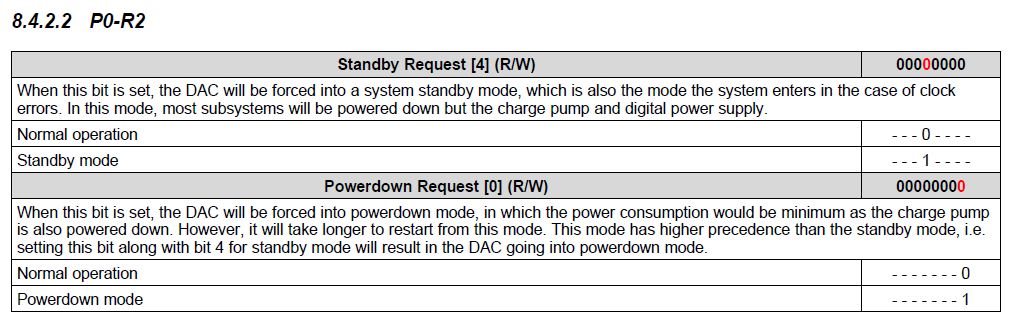

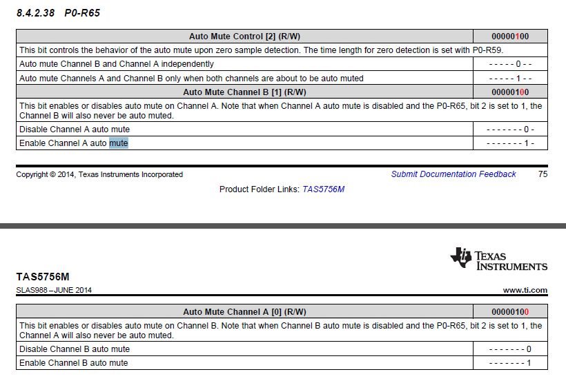

I am trying to use TAS5756M for audio application, but nothing hearing on the outputs.
Analog audio is direct connect to the SPK_INA/B, with the suitable amplitude and offset, digital audio is left opened, and the GAIN is set to 26dBV.
Also SPK_FAULT is high, so there isn't any error...
So, can anyone help with that issue? Is there any special configuration about using just the audio part of the amplifier, not DAC?
