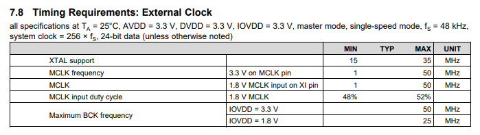

Hi Team,
My customer used PCM1864 and asked about the input XI/XO and SCKI clock frequency deviation and jitter requirements for our device. There is no such data in the datasheet. They plan to review the design and evaluate the signal quality in their system. Thanks.
