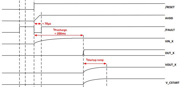

There is a problem that initial sound is cut when music is played.
I think that it is occurred due to long precharge time of VIN_X after high /RESET.
So, I want to know how to reduce the precharge time of about 200ms like below picture.
Please let me know this solution.
