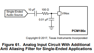

I'm designing an ADC board with the PCM1865 that will interface with a DSP. I'm trying to design a high quality card that is somewhat generic so that the ADC can be used for both single ended and differential line-in applications.
Question 1: How important is the AntiAliasing Filter mentioned in the datasheet? We are using this primarily for "pro-audio" in "live production" style work. (mics (requiring preamp), powered speakers (balanced line-level), cd-players, DVD players, etc).
Question 1b: Assuming we have a powerful DSP, can it provide the AntiAliasing Filter, or does it have to be done in analog?
Image: PCM1865 Datasheet Page 75.
Question 2: What is the 100k resistor tied to ground, as found in the PCM1865EVM datasheet? It appears that the EVM doesn't have an antialiasing filter at all, so is that my sign that I don't need it?
PCM1865EVM Guide Schematic. Pg 15.
