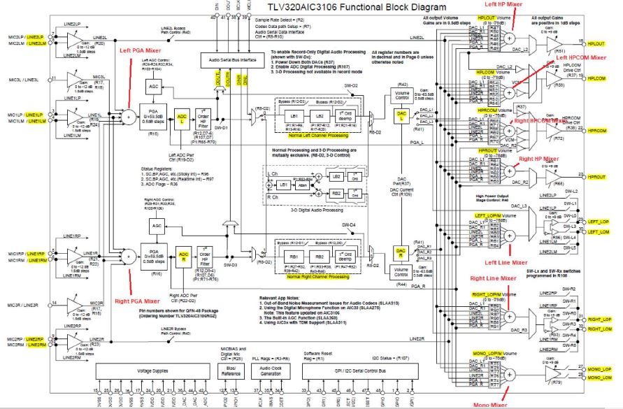

Signal Path:
Right Line Mixer:
Simple mixer control 'TI Right Line Mixer DACL1',0
Simple mixer control 'TI Right Line Mixer DACR1',0
Simple mixer control 'TI Right Line Mixer Line2L Bypass',0
Simple mixer control 'TI Right Line Mixer Line2R Bypass',0
Simple mixer control 'TI Right Line Mixer PGAL Bypass',0
Simple mixer control 'TI Right Line Mixer PGAR Bypass',0
Mono Mixer:
Simple mixer control 'TI Mono Mixer DACL1',0
Simple mixer control 'TI Mono Mixer DACR1',0
Simple mixer control 'TI Mono Mixer Line2L Bypass',0
Simple mixer control 'TI Mono Mixer Line2R Bypass',0
Simple mixer control 'TI Mono Mixer PGAL Bypass',0
Simple mixer control 'TI Mono Mixer PGAR Bypass',0

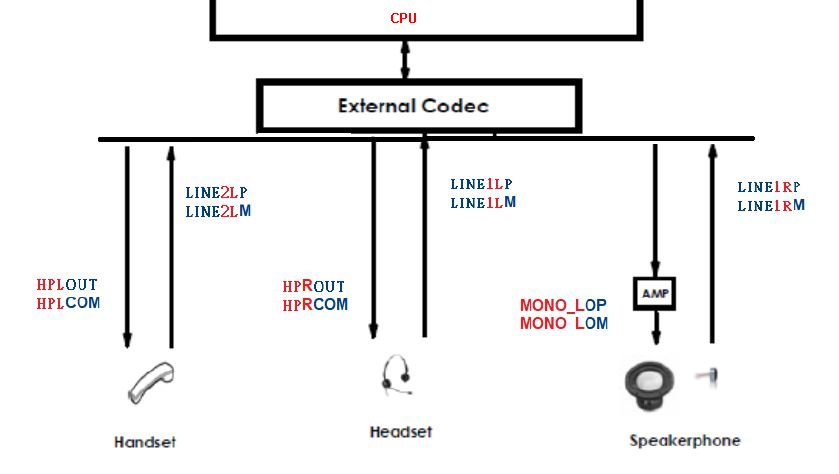

Because the AIC3106 GUI is not compatible with Windows 10 OS, hence we are not able to test I2C coding on the EVM.
Would you please assist us to point out missing or mistake with the I2C configurations we captured on customer's system board (The CFG is not functional now)?
We can send schematic by Email:

    Also, in your second configuration you are setting the PGAs to their highest gain setting, which I do not recommend,
    You don't end up routing the Line2R,Line2L, PGAL or PGAR signals to the output mixers, but the Right and LEFT DACs are routed, however.. you set the LEFT and Right DAC volume to -23.5, and then you set the Mixer volume to -23.5 so you attenuate the DACs significantly.
    Can you explain exactly what you are trying to do?

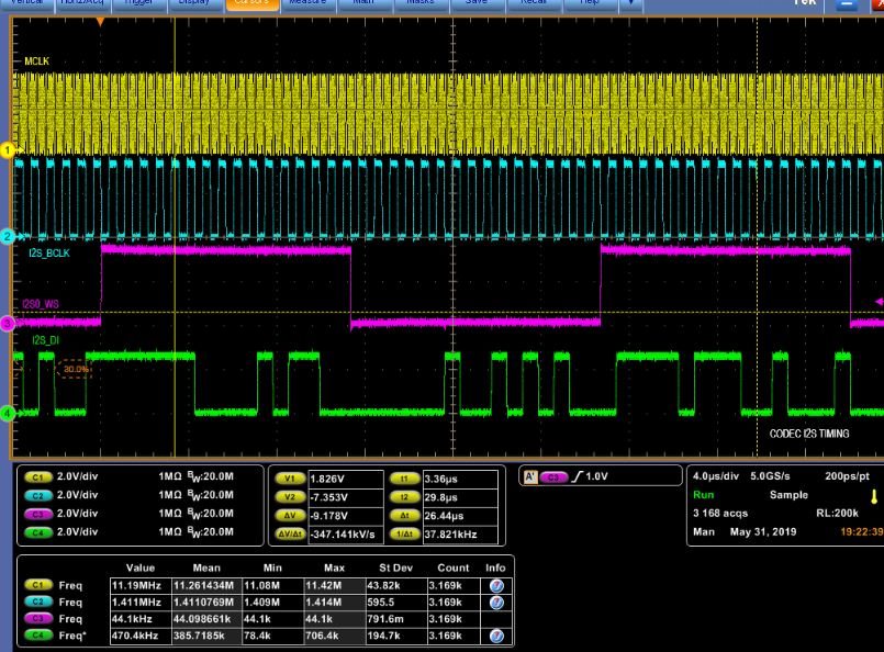

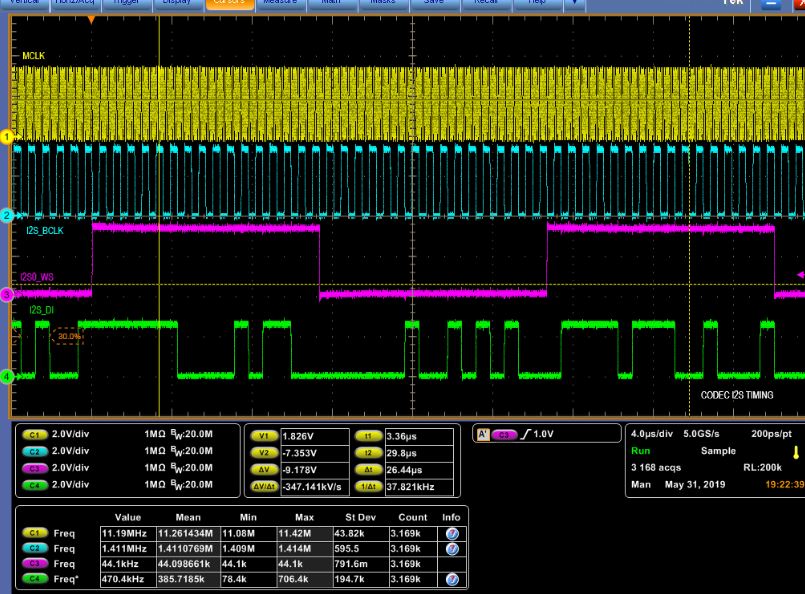

    Customer is updating Linux driver based on your recommendations. Here we have some questions need your suggestions:
    1. Do we need to keep MCLK all the way?
    2. We are testing 44.1kHz sample rate with 11.2896MHz MCLK. The system sends the following instructions during power up:
    w 36 07 0a

    Memory dump data is in line with your recommendations for clocking. However, there is no sound with LINE2L input to HPLOUT & HPLCOM. Would you please assist us to check if there are missing or mistake?

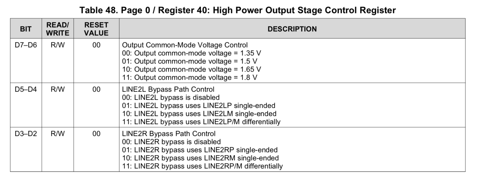

  • Wayne,
    1. Please clarify.  What do you mean "keep MCLK all the way"?  do you mean keep it constant? keep it running?
    2. if you want to use the Line2 Bypass path, you must program register 40 (bits D2-D5)  right now these are set to 0,  meaning the bypass path is disabled.
    best regards,
    -Steve Wilson
  • Hi Steve,
    Thanks for your concern.
    1. Customer's SOC can send MCLK when music stream startup, and turn off MCLK when music stream stopped. Do we need to reprogram the AIC3106 after MCLK power cycling? Should we keep MCLK always on to reduce software effort?
    2. Thank you for your advise. We will test it and get you back shortly.
    Thank you and Best regards,
    Wayne Chen
    06/05/2019
  • Hello Wilson,
    Thanks for supporting. The loopback path is functional with register 0x2d = 0x80. However, we are not able to play sound from CPU. We are checking CPU's I2S format and will need tips of customer's signal path configurations.
    Wayne Chen
    06/06/2019
  • Wayne,
    1. The MCLK does play a role in some of the important features of the AIC3106,  such as the pop suppression and soft stepping. so it does help to provide thisclock constantly.  The AIC3106 should have the DAC and ADC powered down when changing the MCLK frequency and sample rate (and programming the associated registers)
    2.  sounds good,  Thank you for your work Wayne.
    best regards,
    -Steve Wilson
  • Hi Wayne,
    The line2L bypass will only work once register 40 is also configured.
    best regards,
    -STeve Wilson
